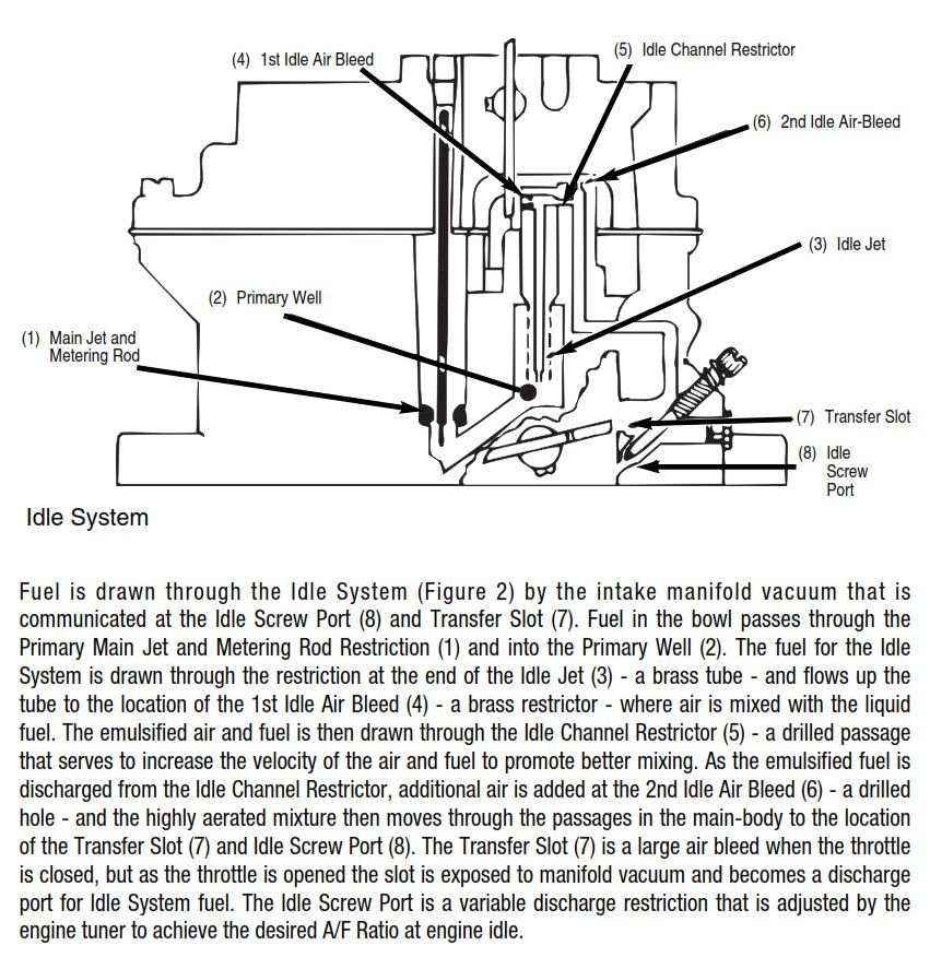

Originally Posted by keithinspace
The idle circuit? Venturi effect from the idle ports at the base of the carb near the butterflies.
No, you and I were both wrong on this. Sorry, it's been so many years since I studied the Holley technical literature, I just forgot some of the details. I don't have any of those books now, but here's an excerpt from one of the Edelbrock manuals. Their idle circuit is similar in operation, and they clearly state that manifold vacuum pulls fuel out of the idle port. In other words, if the butterfly was positioned between the idle port and transfer slot, then sealed around its edge so no air could flow, vacuum below the carb would still pull fuel from the idle port. Velocity through the bore isn't needed. The transfer slot also uses vacuum to pull fuel, not velocity.
Thanks to SH-60B for hammering this home.

[QUOTE=454Luvr;1591043884]No, you and I were both wrong on this. Sorry, it's been so many years since I studied the Holley technical literature, I just forgot some of the details. I don't have any of those books now, but here's an excerpt from one of the Edelbrock manuals. Their idle circuit is similar in operation, and they clearly state that manifold vacuum pulls fuel out of the idle port. In other words, if the butterfly was positioned between the idle port and transfer slot, then sealed around its edge so no air could flow, vacuum below the carb would still pull fuel from the idle port. Velocity through the bore isn't needed. The transfer slot also uses vacuum to pull fuel, not velocity.
[/QUOT He sees the light......
