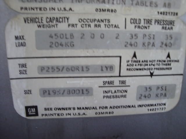

I'll be honest...I was actually doubting I could resolutely prove my point until I found the sill placard from the 1982 car. That really tells the tale, doesn't it?
In case anyone doubts that is from a Corvette, look at the weight capacity and number of occupants. I don't know what other car Chevy put out that only carried 450#, 2 occupants, and used 255/60R15 tires.

Whichever of those two things happened, the evidence is VERY clear.
The EARLY radials had low recommended pressures, but for the LATER radials...
---SAME MAKE of car
---SAME GENERATION of car
---SAME weight
---WIDER tire (225 early to 255 late)
...the manufacturer increased the recommended COLD tire pressure by 75% over the course of 8 years of fitting radials to that particular car (the Chevrolet Corvette).
(For those of you that aren't big math geeks, that's the better part of double.)
I mean this in the most sincere way: There isn't anything left to say. The tires manufactured today are more similar in construction to the tires fitted to the 1982 Corvette than the 1974 Corvette. Period. Every single scrap of evidence points to that fact.
I COULD say that I'm right because I'm a Mechanical Engineer. But that's not true. I am, indeed, a Mechanical Engineer, but that doesn't mean I know crap about tires. I'm basing the above FACTS on evidence derived from investigation and common sense.
ANYBODY CAN RUN WHATEVER PRESSURES THEY WANT IN THEIR TIRES!!! I'm not trying to convince someone to do something different. I'm just trying to debunk what is clearly erroneous information.
FWIW, personally, I'd start at 32 and tweak up and down from there based on tire wear.
Uh, did you happen to notice the sticker says MAXIMUM LOAD?
