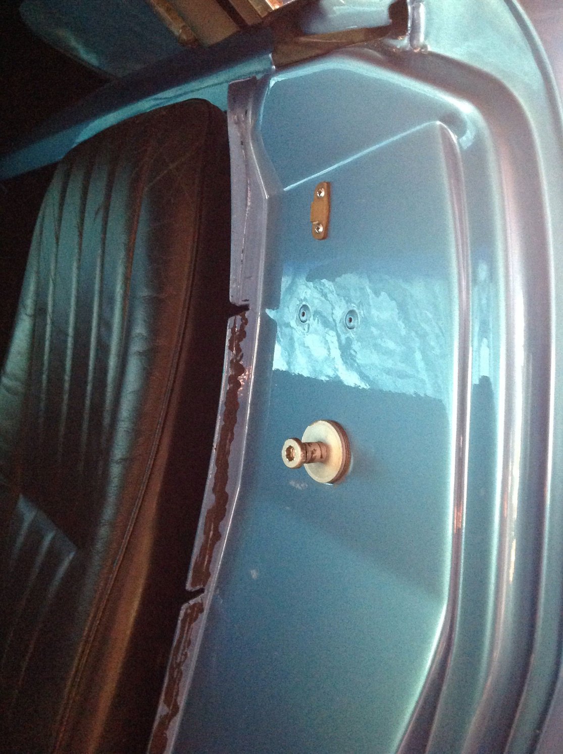

68 just came back from the paint shop. Looks great back to original blue
Not quite sure the paint shop got all the hardware on the doors around the catch quite right.
Can some post a pic of their door catch area and the pillar area where the post is. See mine below. I checked the aim but couldn't quite find what I am looking for.

Hi Cc,
NEW PAINT!!!! Nice!
This AIM page shows the 'plate' and 'spacer' and their location on the door…. those unused 2 holes.
Various vendors have these parts.
I believe the configuration changed for 69.

Thanks Alan!
Also,
Here is a set:
http://www.corvetteamerica.com/cf/part.cfm?partno=26667
Forget which side the brass piece goes on. I think the brass is on the door and the matching plastic piece is on the door jamb.
I think this is unique to the 68.
BTW, when you install these, be careful to get them in the right place, use a marking grease or something similar, if the brass piece over travels the plastic wedge, it then becomes very difficult to get the door open, LOL's! Don't ask me how I know this!
Hope this helps.
Paint shown looks nice!

Hi 20,
I believe in 68 both sides (door jamb and hinge pillar) were made from gray plastic.
I believe it was the 69 convertible that used the long brass wedge. (But again don't know if the brass was both sides or just one.)

Paint looks nice, Le Mans Blue is one of my favorites.
The plastic piece goes on the door jam. A brass wedge was used on the door. Early cars used the wedge shown in the attached picture. Later cars and early 69s used the same plastic piece on the jam, but the brass door wedge changed to a longer shape.

Cheers guys,
Knew it would be in the aim somewhere. Must have glossed over that page as thought it was just the handle.
As my wife would say must have had a man look.
20 thanks for the tip on the brass, I could do without that complication!

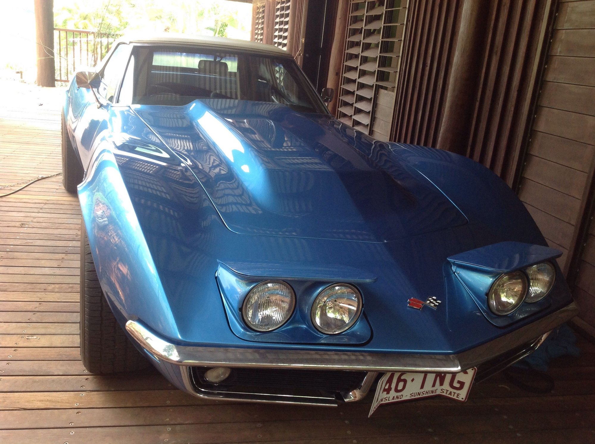

Btw. A bit bigger pic
Yep lemans blue. With a little extra pearl in it.

Hi Cc,
OOH!
Very nice looking convertible!
I'll bet you're really excited and pleased to have it back!
