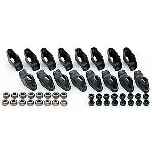

How do I tell what ratio my current rockers are? Changing just these could add 40+ or this plus the E series heads?
If you have stock looking forged or cast rocker arms (and typical pressed in studs), it is more than likely that you have 1.5:1 ratio rockers.
A set of 1.6:1 rockers will add additional lift to your current cam and provide a boost in power. With your current heads however not a lot. Also depending on the pistons you have, you may or may not have enough clearance to run them.
