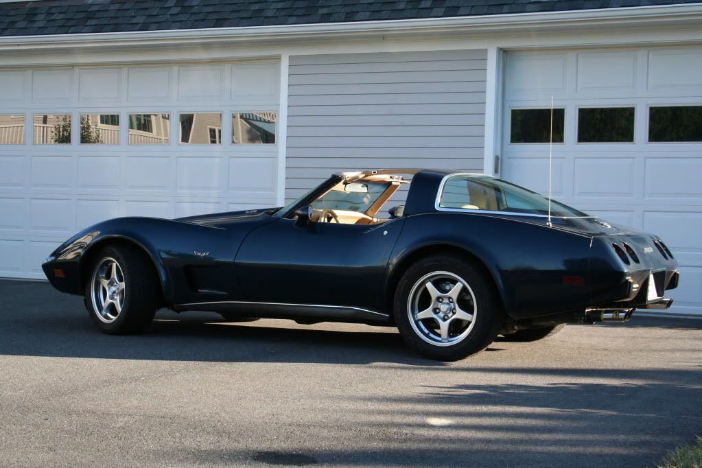

Here is 17x8 and 18x9 245-45-17/275-40-18, widest rear tire with stock trailing arms and body work is the 285. depending on your back spacing/off set you may have to relocate the e brake. Some say you an get a 275 on the front without rubbing but you have to be very precise with your measurements.
Nice Color....not many C3's have our colors....
Thanks, I need to get rid of those pin stripes but they are under the clear.
