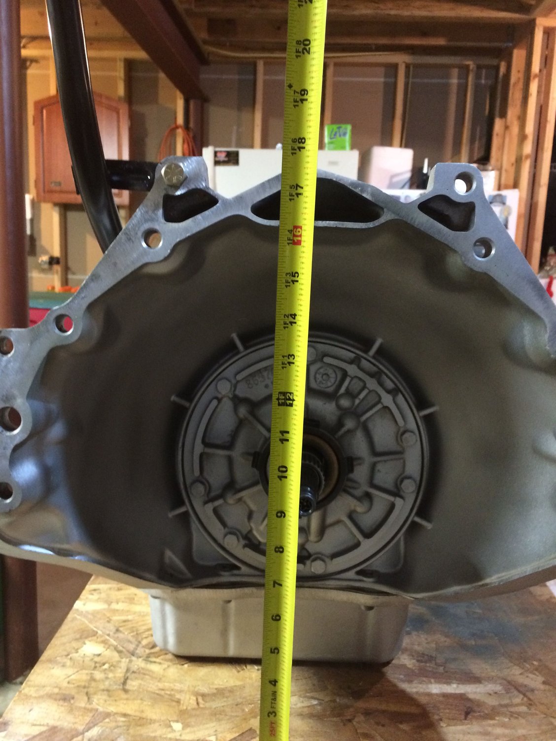

And finally, any idea just how high I need to get the car on jackstands to slide the tranny underneath? Basically, what's the measurement to the top of the bellhousing with the tranny sitting on the ground?

You will need at least 18" to be able to slide it out with out the trans jack.This is 19 1/2". I just don't trust jack stands in the full up position.

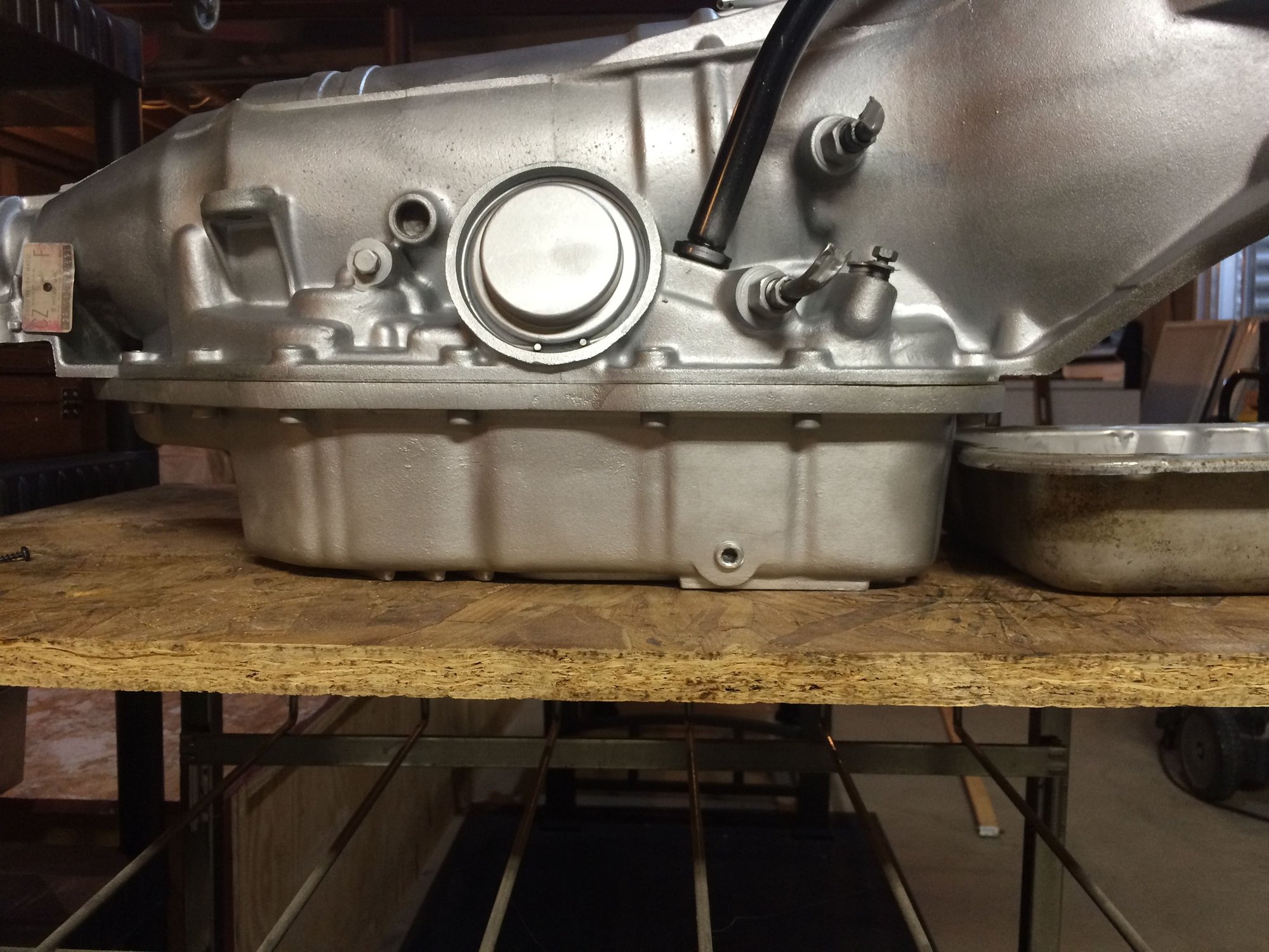

My spare 2004R has a deep aluminum pan on it and the top of the trans is just under 18". The regular pan is 1 1/8" shorter than the deep.
