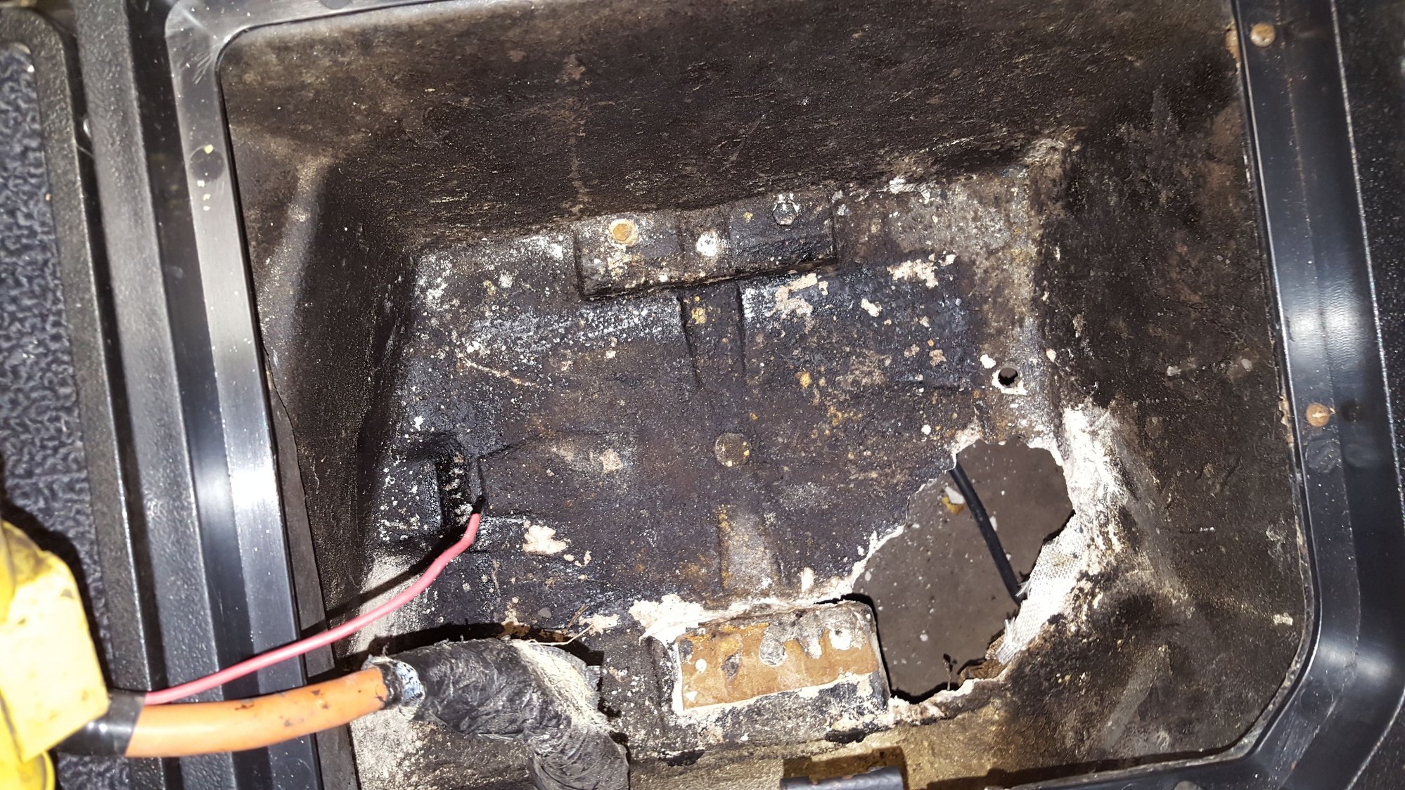

Here is a picture of the cancer....looks pretty bad .
The first job is to clean as much of the white stuff off....thinking about using a can of coke!
Theoretically the acid should neutralize the alkaline.

I am thinking your battery has sulfuric acid so you might consider sprinkling baking soda (base or alkaline) and then flush with plenty of water.
My 68 had the same battery box problem, fairly big hole and a large crack, but 75% remaining maybe, I taped the bottom up to prevent the resin from dripping out and then matted in a number of layers of fiberglass cloth. I then put a layer of plastic down and then put the battery in while still wet to hopefully get the bottom of the battery shape impressed in the fiberglass. Next I installed new battery hold down brackets.
Hope this might help, the battery tray idea above sound like a good idea too.
The good news is Corvettes are fiberglass, I have to believe Corvette repairs like this are easier than fixing sheet metal.

Or baking soda and water.
