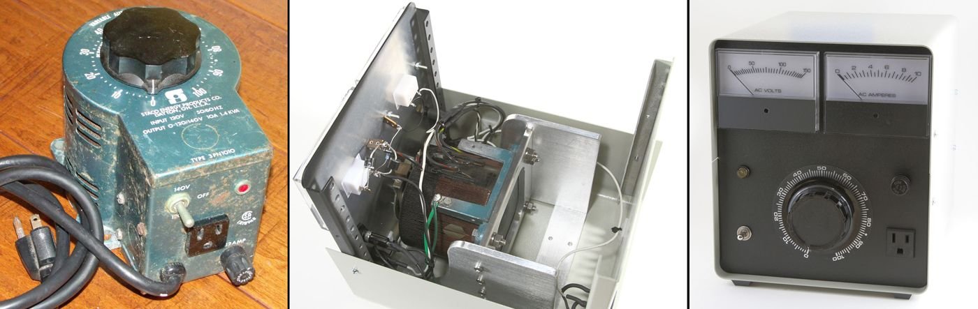

Had this old variable transformer lying around, but needed it to be metered. Used the mill to build a bracket system using 1/4" 6061 plate, then remounted the guts in a modern case. The bracket had to be really stout, because the transformer core is heavy and the new case is only light gauge aluminum.

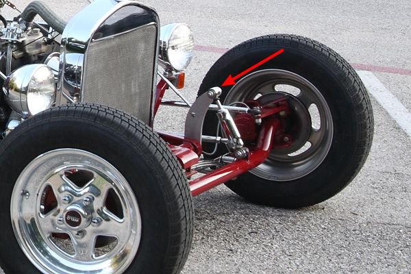

My T-bucket originally had friction shocks on the front, and I wanted standard hydraulics. So, I made a set of shock brackets from 3/8" 6061 plate. The holes for the shock bolts were cut oversize and bushed with Oilite sleeve bearings from McMaster-Carr.
