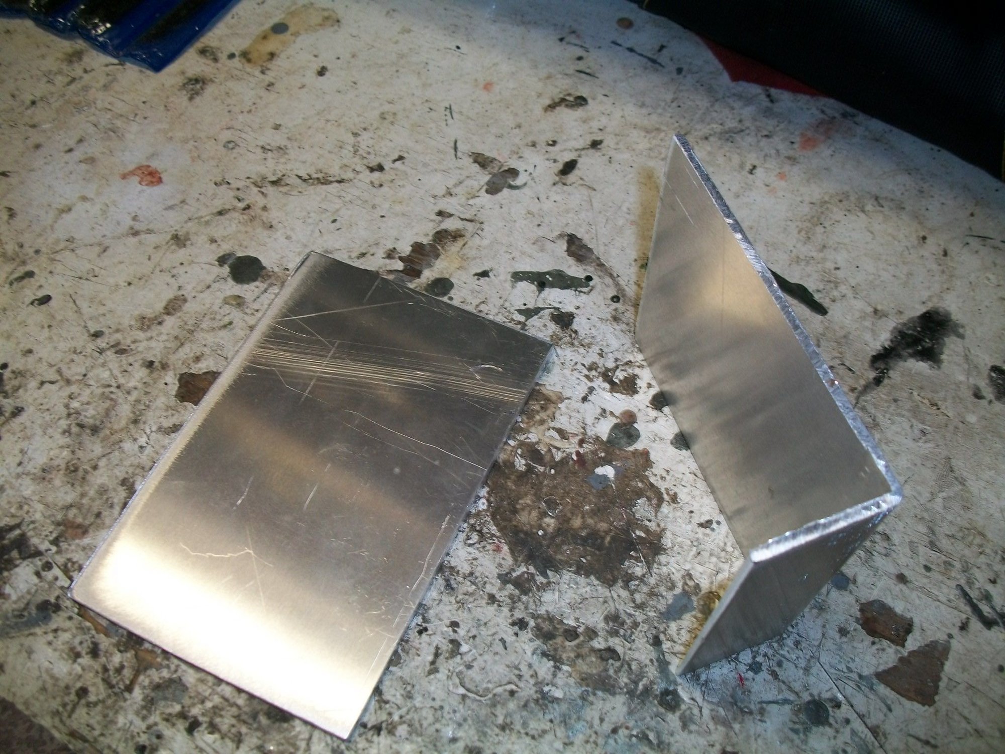

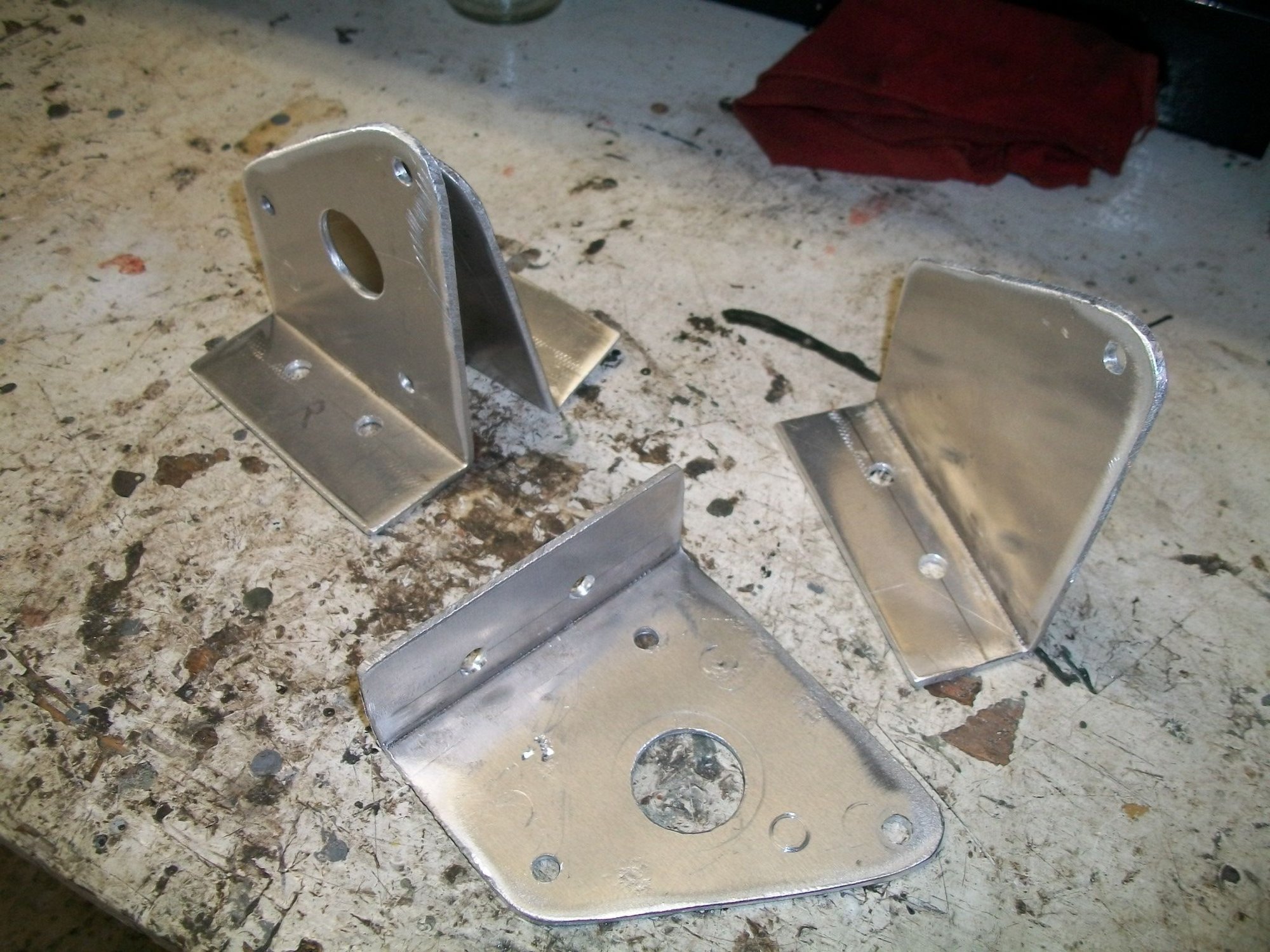

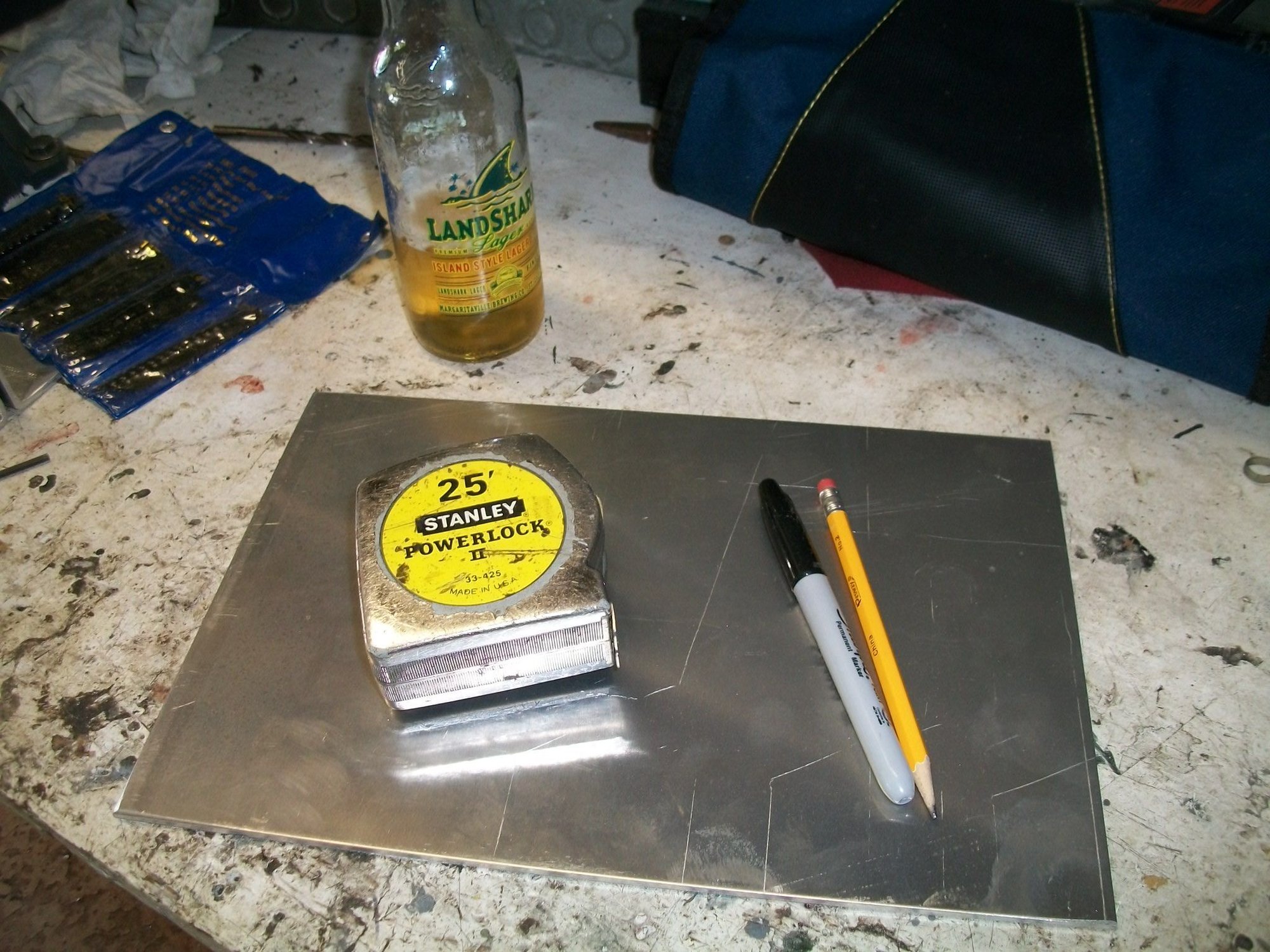

New or re-man. at your local auto parts store.
Bracket was easy.... but don`t forget the beer!
I made two for each motor, because I`d heard of them flexing a little when operating. So with them sandwiched between dual brackets, they don`t move at all! Note that the one for the back side does not need the hole for the rotating arm.
Many thanks to Richard for all the info & pictures for this.... and other cool ideas!

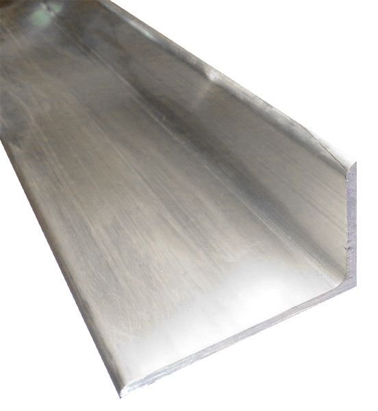

As you probably have experienced in fabricating something for yourself. Even if you bend and make bracket out of thick steel...the dynamics of 'whatever' can put a stress load on the bracket and cause it to move. I have run into this more times than I care to remember and a lot of it deals with some key specific bends that GM can have in a part due to the dies used to stamping it out. Which allows GM to use a thinner gauge of metal But trying to put these key bends in the 90 degree bend of the part when using a box/pan break machine....just can not be done. Or at least I have not figured that one out yet. I make a lot of brackets out of thick 1/8" aluminum and have made them out of steel and come to find out that the bracket s still moves due to the 'angles of the dangles'. Yes...the movement is lessened...but until an additional brace or bracket has been employed...that is what stops any movement.
DUB
The problem here might be the size of the foot. At 1-1/2" wide, it's probably too small relative to the work and weight involved. I suspect two brackets are required regardless of thickness if absolute stability is required. As for bending sheetmetal, that wouldn't be necessary in order to make brackets. Angle aluminum is readily available in sizes that will do the job. Pieces of 6061, 3" x 5" x 1/4" thick and 18"-24" long can be found on eBay for roughly $12-15. All it takes is cutting tools to turn a piece like that into four brackets.
Bear in mind it's not that easy to work with 1/4" aluminum, especially if the finished product is an odd shape and holes need to be precisely aligned. Even with a small CNC mill that I use for aluminum work, I think it probably wouldn't be worth my time to do this myself. Richard's price is very fair, and he can supply them in stainless. That's really the way to go.

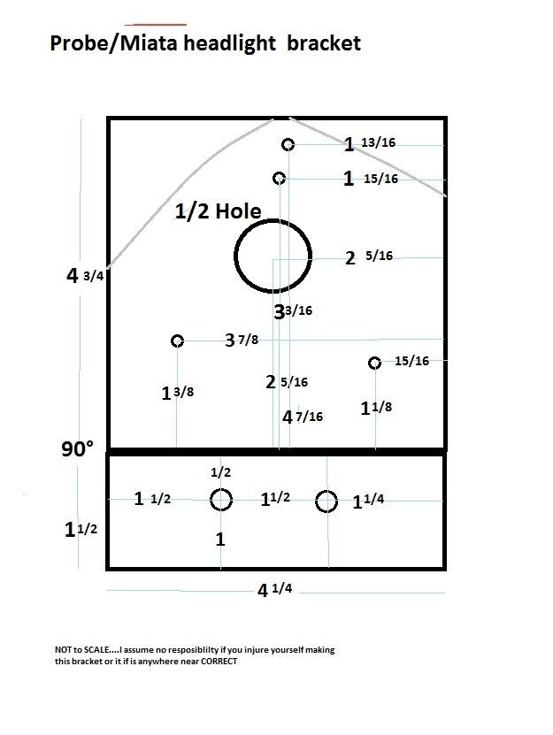

454, I have the bracket templates all done up in a pdf file. If you PM me your email address, I can email you the pdf file.
I completely understand the foot of the bracket. I encounter it often when I have to fabricate some brackets where the supporting and function of 'whatever' causes for the bracket to flex. I also work with polished stainless steel. YES...it is much stronger when bent.
Yes...ordering or going out and buying angle aluminum I have done on many projects where I need that perfect flat foot in relation to a perfect 90 degree angle.
So I am not at all complaining. I was just saying that having an extra plate or gusset for rigidity and support...is fine by me. Just in case it came across differently
I envy you having a small CNC machine. MAN...that can open up so many possibilities for me when I fab stuff. I can get stuff made...but that is not the same as keeping it in house and able to make changes if needed.
