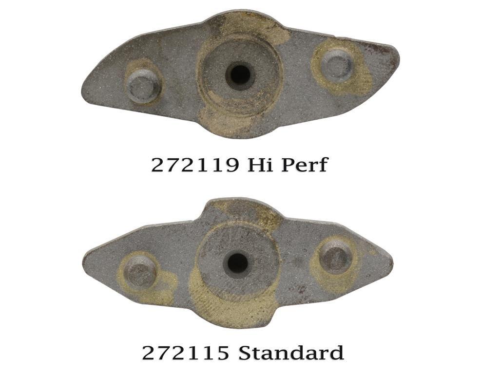

Paragon has both standard and high performance shafts the difference is the top cam. I have measured the curves the two top cams give. The HP one basically gives you the same curve as in the Chevy power book, very linear. The standard cam has very retarded timing for the first part of the curve and would hurt power. It would work fine in you 427 390 and probably be very close to oem if you do not want to go welding.

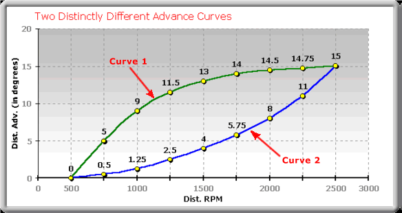

Below are the two available cam shapes:
Below is a chart from TI specialties showing the full range of Chevy's 28 advance cam curves: This shows a 10 degree variation at mid-rpm.

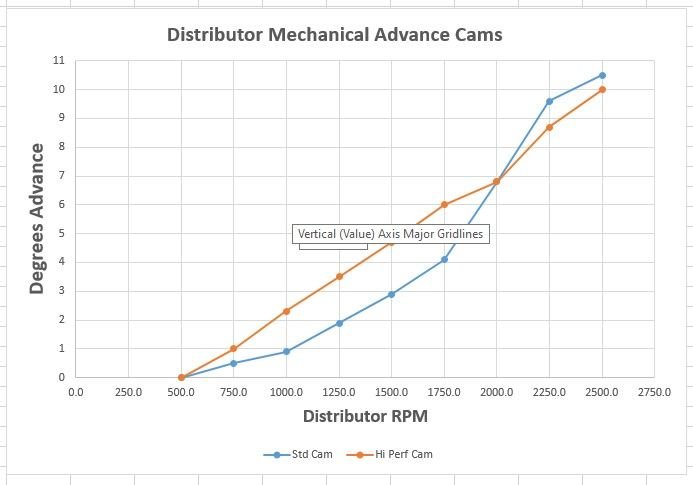

Below are the results of my own testing on the two currently available aftermarket advance cam curves. (I may have a little measuring error on the last couple points they don't look smooth enough)
The Hi Perf curve is virtually dead linear, and at mid-range advances the timing about 4 degrees more than the std one.
The 1964 327-365 was the last real chevy to get a 100% performance ignition curve from the factory with a lot of initial and total all-in by 3000. Every thing after that was a compromise between emissions and performance, with greatly retarded timing at many rpms, total not arriving until 5000 etc, vs the optimum advance curve as listed in the chevy power curve which is virtually identical to the '64 365 BTW..
A linear advance curve is what you want, and that is exactly what the Paragon High Perf part gives you. I confirmed it.
Then change your springs til you get all-in by 3000, and set your total to 34-36. It'll run a lot better and you will feel the difference.
If you are all about 100% stock just use the High Perf cam. It will be within a couple degrees or so of your factory one and you'll never feel the difference.
It'll work with your TI distributor.

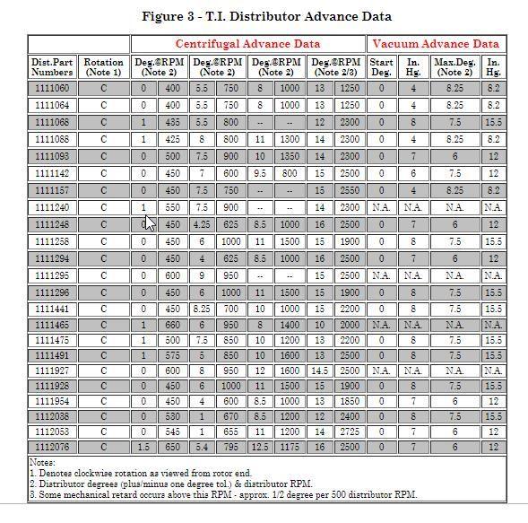

Oh and here is that chart from TI Specialties that gives all the original OEM distributor advance curves for the TI distributors:
You just have to figure out your distributor number. Notice the first two has total all-in at 1250, that's 2500 engine rpm, that's the "hot" one.
Everything else is retarded so all-in does not occur til 4000-5000 engine rpm.
