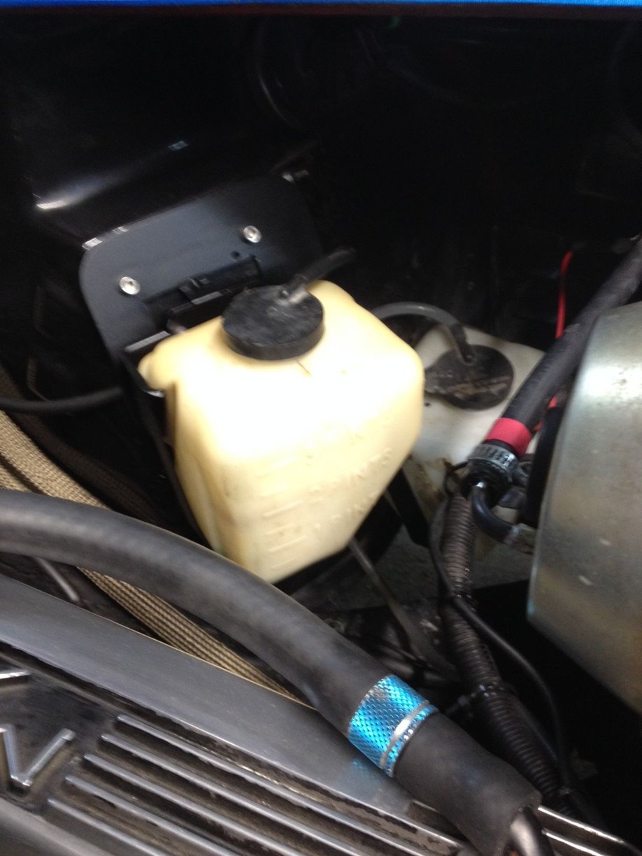

There was no overflow tank on my 70 when I got it, in fact even the little spigot for the hose on the radiator was missing. I fitted this and a hose that dropped down beneath the radiator but if you filled the radiator too much it would flow out the hose and the fan would pick it up and blow the coolant around the engine compartment making a mess. Besides coolant with antifreeze in it is toxic and I don't like the idea of some dripping on the ground and maybe one of our cats licking it.
So I fitted an aftermarket 1 litre bottle but this has proved to be slightly too small. I happened to call in at an out of town auto wrecker the other day and they had a three pint one off a chevy (I don't know what model) this one works like a champ and only cost $20.00
Overflow bottle on 70 vette. Not std but lots of things aren't on this car.
