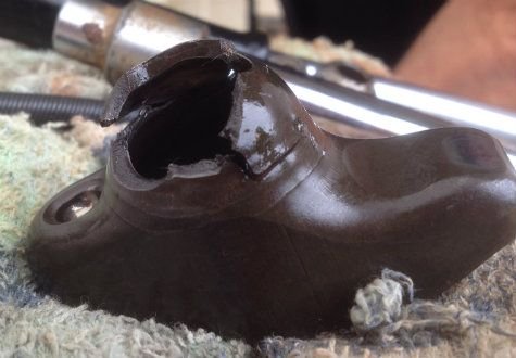

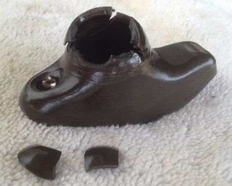

Thanks everyone for your advice. As suggested, I took both valve covers off and discovered cylinder 6's had a rocker arm which was not aligned to the valve (twisted 45 degrees). It was still attached but had 3 pieces broken off. All pieces were found next to valve. See images. Replaced rocker arm, cup and locking nut. Rolled push rod on glass and is not bent or damaged. Googled how to adjust hydraulic lifters. Further investigation of other rocker arms identified that ALL needed adjusting. One in particular was very sloppy cylinder 1. I think this has been the initial tappet noise in engine I have been hearing. All back together and running smoothly (and much quieter). I think I got out of that one cheaply. Thanks again for your help.
