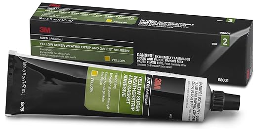

I like 3M 08001 Yellow Super Weatherstrip.
