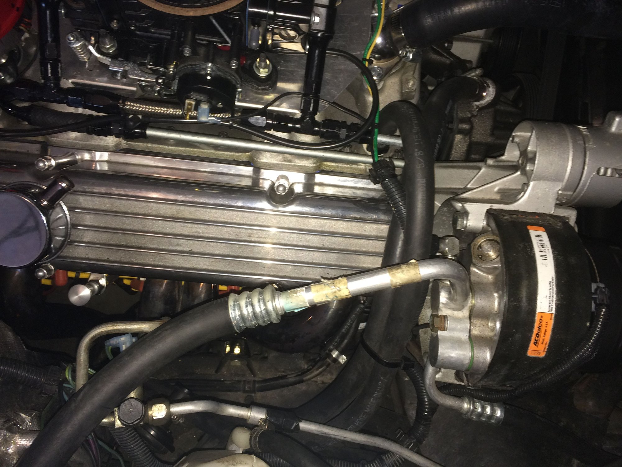

Sure, here are a couple views below - the close-up may not be as helpful as you wanted. My engine bay is not much to show off - please keep in mind I'm more interested in functionality than showmanship....
When removing the valve cover I have to pull the hoses to one side - it is tight, but there is enough room.
Also, check the clearance behind the alternator and your driver side valve cover. I recall having to grind and repolish a small area at the front end of my driver side aluminum cover to avoid the output post.
I like this as a mod, just lots of little details that you find as you get into it.
A few other things I learned:
- The power steering pump can be either the F-body or the original (year depending) but you may need to change the hose fittings if you use the F-body pump. I also have steeroids and that required a new (longer) set of hoses.
- The lower rad hose can be the stock hose but you might need to trim the engine end a little. It's also slightly looser than the stock pump and I did have to tighten up the clamp pretty good.
- The upper rad hose needs to route 1 of 2 ways, I have seen both done on this forum:
1- straight forward and 90* to the left to the radiator neck
2 - over the driver side valve cover
The direction will dictate what kind of thermostat housing you will need. I went to an autoparts store and explined what I was doing - they helped me find a hose that fit option #1 (I found 3 that might work, took them home, and they let me return the unused hoses).
- If you run AC you will need to think about the hose connections, the serpentine pancake compressor that will fit in the brackets is slightly different from the C3 compressor. I contacted a vintage AC company, explained the project (again) and they set me up with a kit for pretty cheap.
- You will obviously need to convert to a newer style alternator - simple wiring mod, Summit has the pigtail
top view showing hose routing
best close view I couple get of the fitting. I beleive it's a 1/2" NPT - I picked it up at autozone while gathering parts for this.
