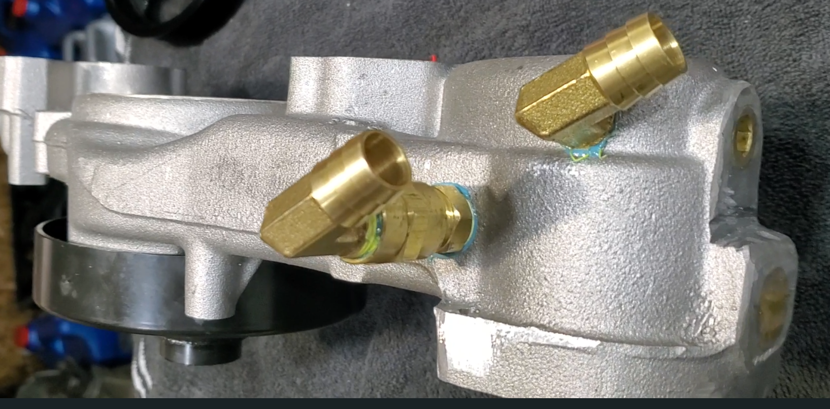

I went with LSX Concepts Corvette mount about 1500.00 using my water pump and Balancer. slight mod to the corvette WP to clear the A arm.
