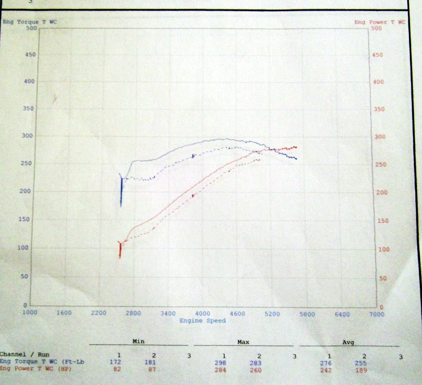

This was my last dyno with current set up. I stopped making RPM @ 5700 due to a bad secondary adjustment. The HP was still climbing when the RPM stopped.
I would like to have all my power by 6000 RPM. With these heads the power comes on late.
Previous run (lower line) was with the valve springs loosing control. You can see it significantly impacted power.
If you figure a 30% loss due to accessories (I have A/C as well) and power train losses it comes out to 406 peak HP at the crank and 426 peak torque.
This is on a Mustang dyno with my 2600 stall torque converter.
With better heads of a more appropriate size I believe that the torque would come up faster giving me a better average torque and better low RPM torque. Like I said though it is still impressive and a blast to drive. My being up at 4000 feet makes the big intake tract issue more pronounced vs a lower altitude operation might.

I happen to agree on the suggestion of a roller cam. It depends on how far down the rabbit hole you want to go. All told the roller conversion cost about $800 additional.
It also came with some headaches in my case. I experienced cam walk despite using a cam button. The cam was walking forward flexing the timing chain cover out. When it did this it also dragged the HEI drive forward with it. That caused some bushing wear issues in the HEI drive that fortunately I caught early enough to prevent replacement.
The fix was for me to reinforce the timing chain cover with 1/8" sheet metal that butted up against the back of the water pump.
You can also buy a more expensive timing chain cover that is much stiffer.
Forwarned if you decide to do it.
