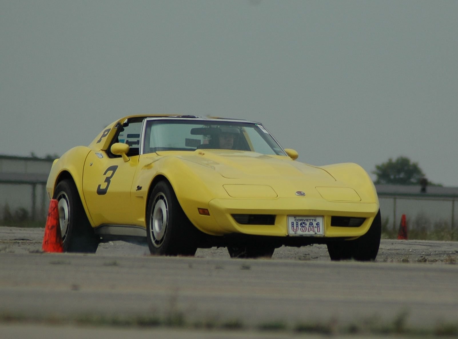

I was browsing the different corvette supply places and came up with a very wide range of prices for rebuilt brake booster units. Also saw that the regular parts stores can get them but takes a day or two. What brand of rebuilt boosters have you got and how was the quality.
Last autocross i ran this year, I would sometimes have power brakes and sometimes wouldn't. If i lifted off of the gas sooner and let some vacuum build, I had power brakes. If i kept my foot in the gas until i needed to brake, most of the time i didn't have any power brakes. So i either have a very bad vacuum leak, or my booster is going bad. I am just looking for opinions on the different boosters out there and why there is such a huge price difference. I saw prices ranging from $66 up to $200.
At Grissom
Rear lockup

I run the II C/D class in NCCC. I have to keep stock style parts on the car so no hydroboost for me. My brakes have always been very good. I can lock up the race tires at will (as seen in the picture above). I just have stainless steel lined stock calipers, Hawk HPS pads and standard replacement rotors. Once you get to the point of lockup, you don't need bigger brakes to stop. The only thing bigger brakes will help with is multiple high speed stops like on a road course lapping day. It will help with brake fade.
I haven't really checked into anything on the brake/vacuum system yet. I was just starting to look at some options if i have to replace the booster. I am going to hook up a vacuum gauge and see if there is a leak somewhere first.
