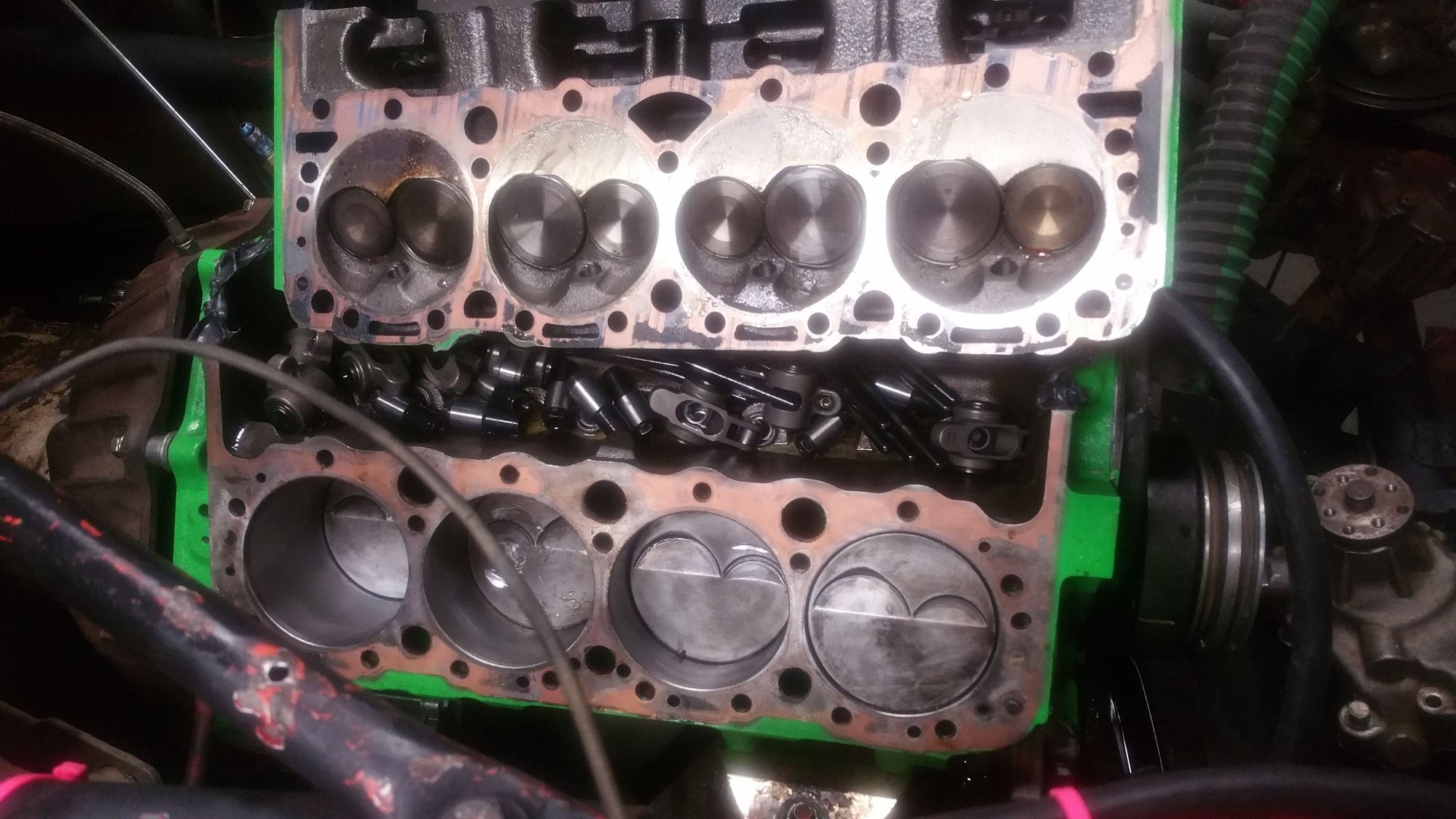

When you read about a company and how bad their products suck, remember there is always 2 sides to every story and in the middle is the truth.
ProMaxx is getting raked over the coals from this Professional Engine Builder because they were told their heads destroyed an engine he built. He is a Professional Engine Builder and they need to take care of him as it was the heads fault. He sent this picture along with the seat that had fallen out and the broken valve. Anybody have a issue with this short block build from this Professional Engine Builder?

LOL, took me a few minutes to see it.

Green block, Mopar?
Is it normal to have that type of setup instead of all the valves the same across?

The valve reliefs dont line up...

Oh wow that sucks! To bad someone mixed up the two middle pistons.

I think he posted it to show that someone can claim to be a professional engine builder and do something wrong while blaming others for their mistake.

Maybe a Pro but attention to detail caused the problem not bad product.

Did anyone point this out to the builder, but if so what happened?

So when I here I have been building engines for 30 years....well this guy told ProMaxx the same.
He sent the pictures wanting them to warranty the entire build because there heads dropped a valve. I have not mentioned any names. This post is to show the public just because you call yourself a professional doesn't mean anything and it also doesn't mean it is always the parts fault.
After ProMaxx got the pictures and they contacted him about the picture with the pistons he has not responded back. I'm sure his ego is crushed.

The uh "professional" engine builder installed the #4 piston in the #6 hole and the #6 piston in the #4 hole. Oops! Engine assembly at it's finest. I wonder if the cylinder head vendors have told him about the horrific mistake he made.

A professional engine builder would have caught this if they would have clayed it out....
