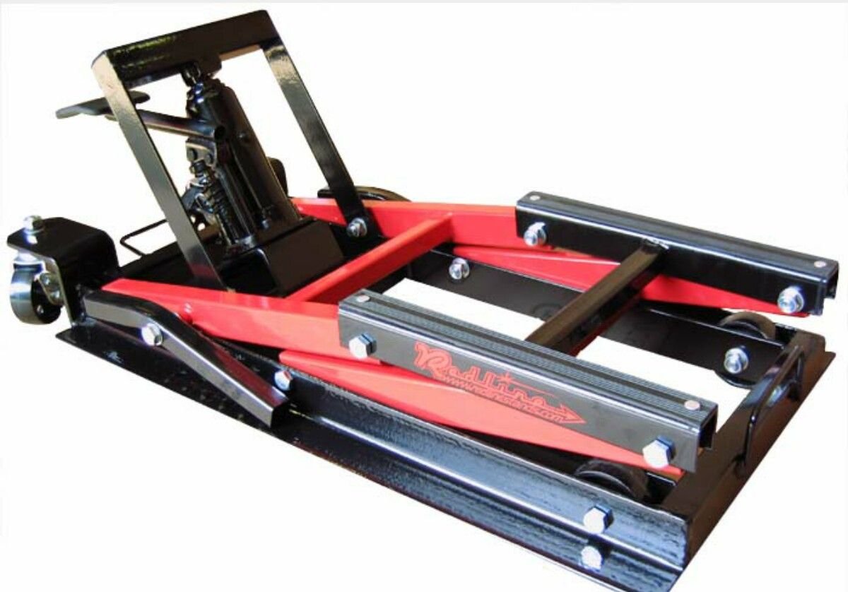

When I rebuilt my rear suspension, I used a hydraulic ATV lift to raise the rear end back into place. I'll probably try that with the tank job, too.

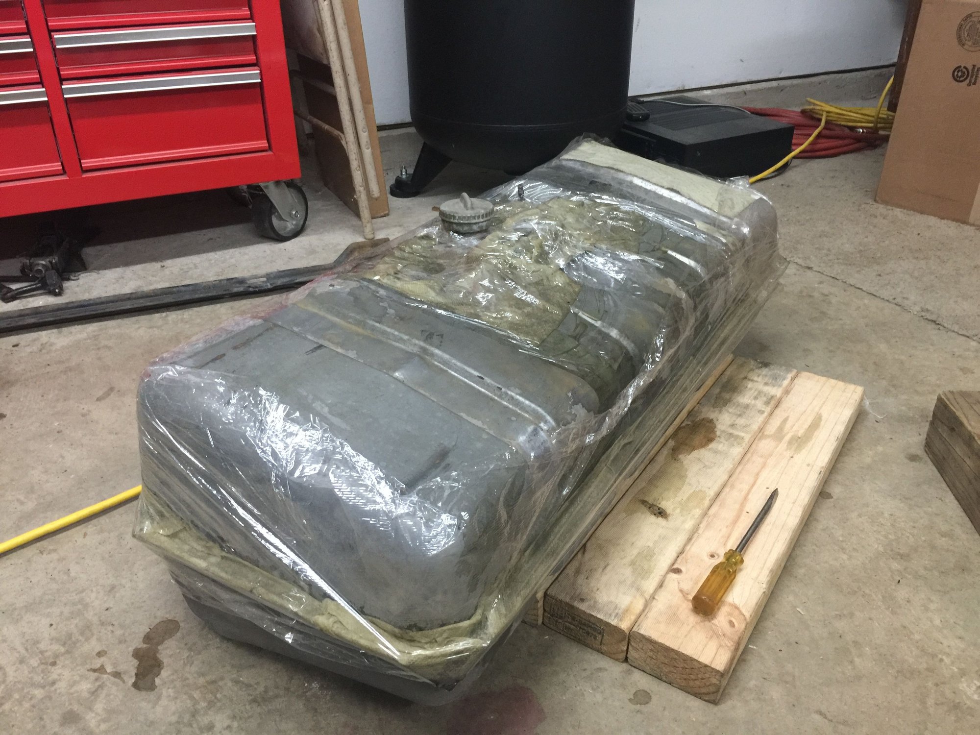

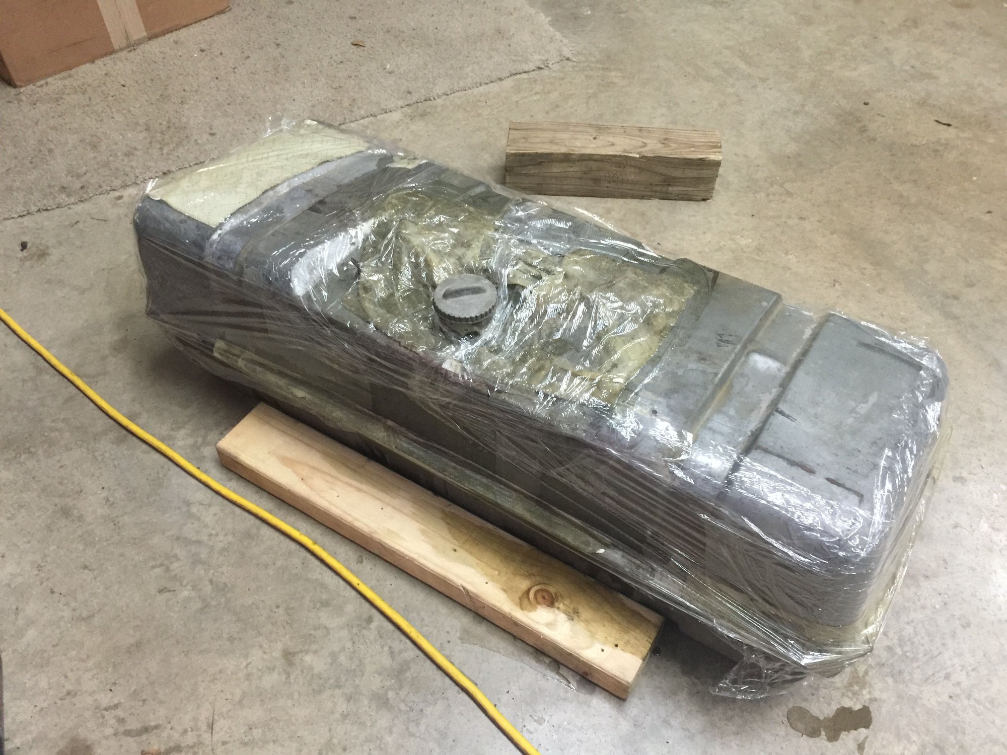

As far as the tank, used the evaporust, paper towels and plastic wrap as suggested. I'll check results tomorrow.

Alright, my evaporust is worn out. Used too much to be effective now. So I picked up some molasses. I'm curious to see how well this works, how messy it is, how hard it is to get off. If it works well, I may try painting my frame with it.
How should I apply it? Concentrated?

You have to flood the area with Evaporust. keeping it wet with paper towels won't do it. Use the "clay dam" method I suggested, and let it soak for 48 hours.
