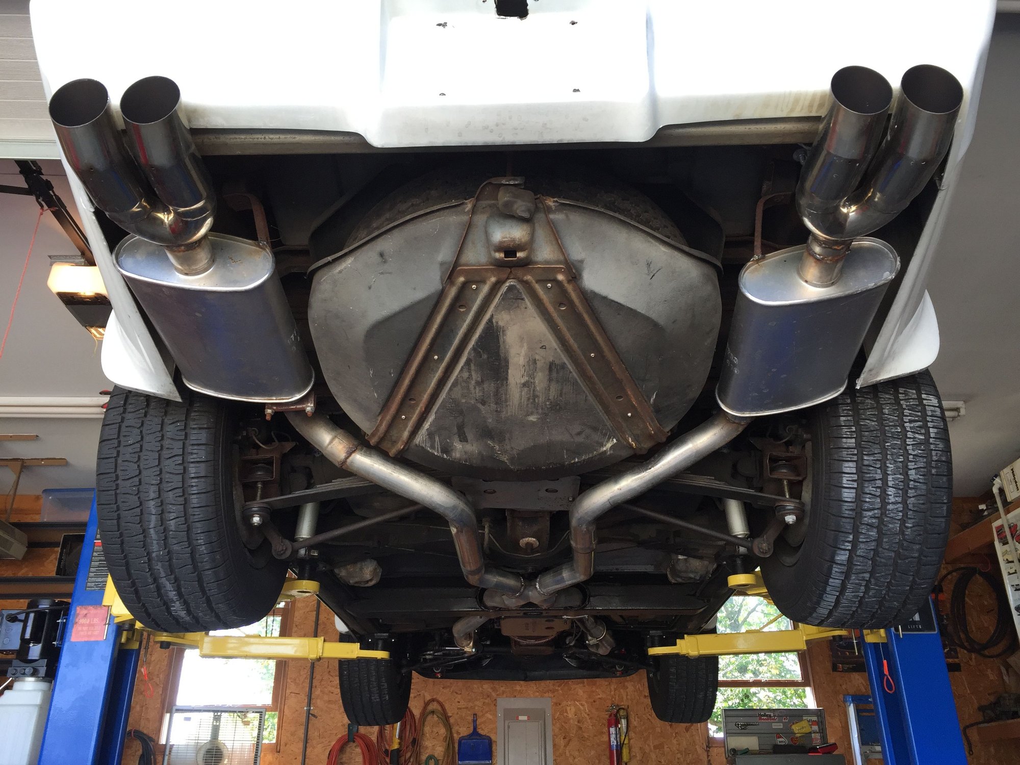

This is what I did last year but it's not friendly. Installing a 700R4 now but had to cut it apart to remove. So take your time.
21/4 to the X pipe 21/2 all the way back
To 76 Exhaust thru Crossmember
