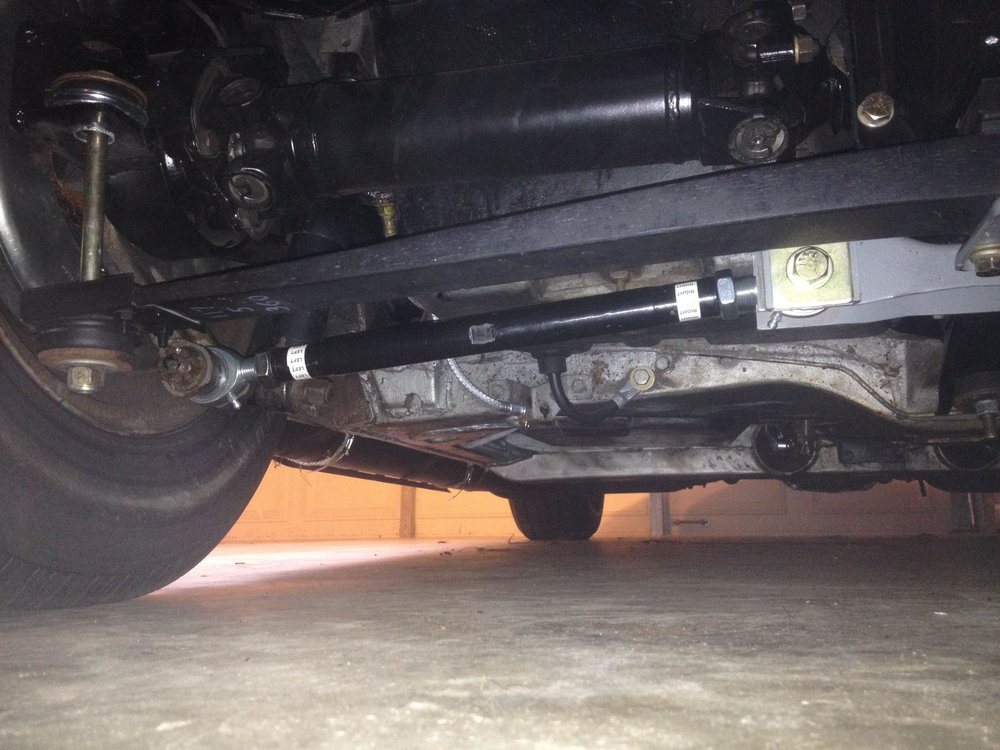

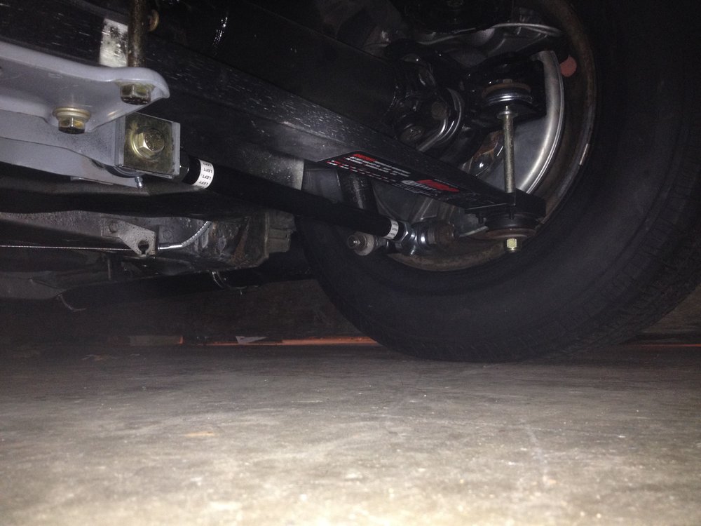

I just installed my adjustable strut arms from VB&P. Nice parts at a happy price. All new hardware included. Plug and play.
I've only taken one trip out with them, but I have nothing negative to say. I mean...they don't make the car FEEL any different. They shouldn't, unless your strut rod bushings are shot right now.
I will say that I had a difficult time achieving AND HOLDING zero camber with the stock system. I had to crank the HELL out of the cam bolt to get it to hold, and that doesn't make me feel good. I don't think you should have to yank on anything that hard to make it work.
Pics of the VB&P units installed:
