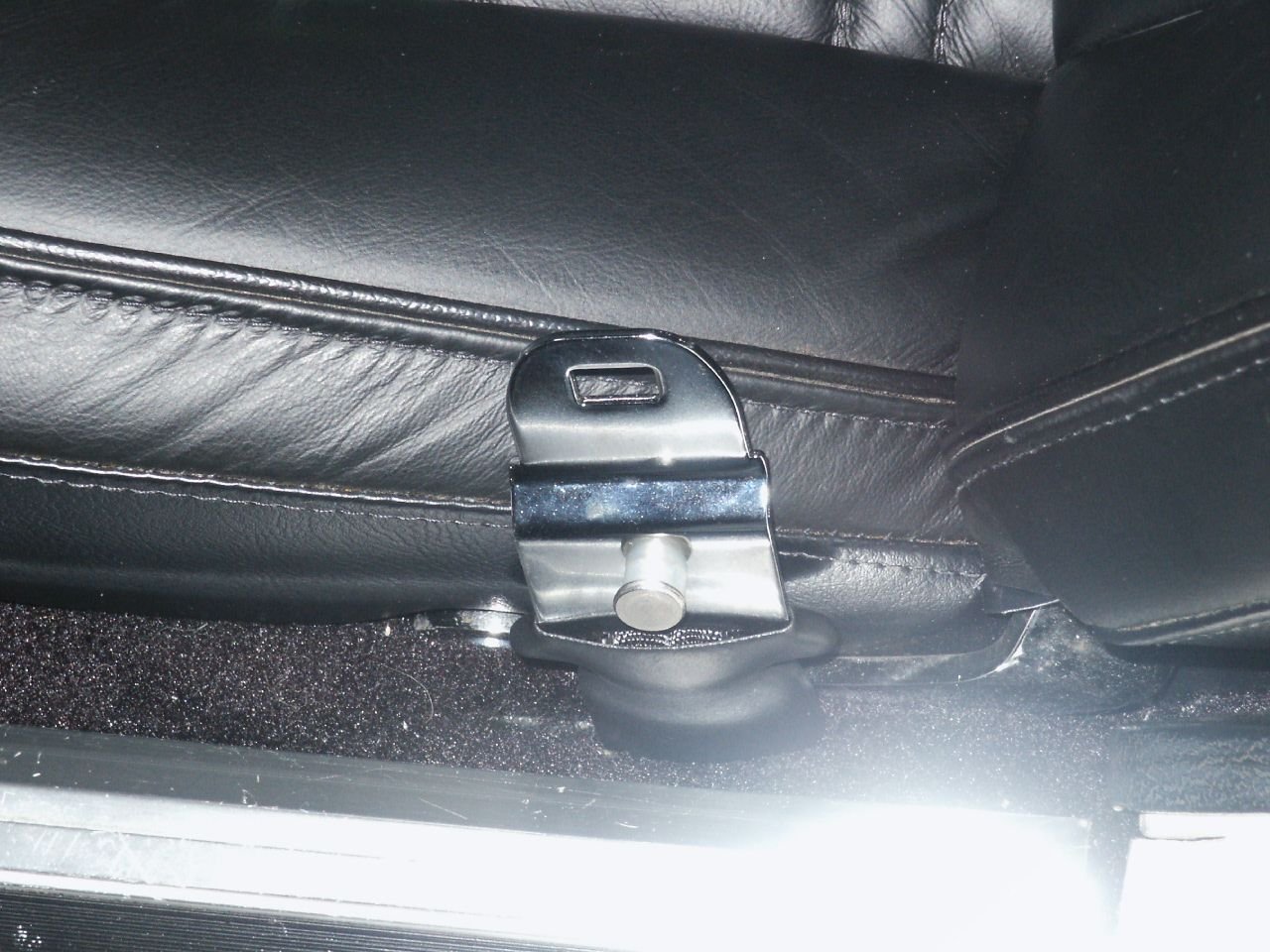

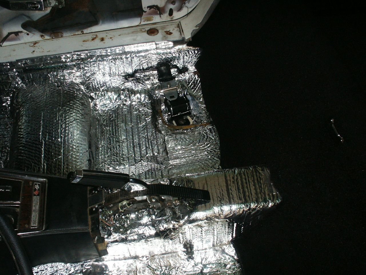

From my 73,
Shoulder harness retractor:
Area at back of seats:
Just took my driver seat out to put in a new bottom foam. Need any shots of that area?

M
y main problem seems to be that my passenger seat seems to far to the outside edge and it pinches my seatbelt. Any shots of the seat belt retractor and the guide (metal u shaped bracket) would help

These are from a 72 but SB the same I believe
HIH

Mooser's pics of his 72 show the same as what is in my 73.

Does the carpeting go under the seatbelt loop/bracket? If not, how/where does the seatbelt come through the carpet?
I had new interior installed on my 75. The seatbelt comes out between the door sill and the carpet. The carpet sticks out and looks frayed.

The carpet was cut around the plastic cover on the original installation.
I chose to cover the plastic cover with carpet instead. Just my preference.
Original carpet cut on my 73.
My installation.
Donnie
