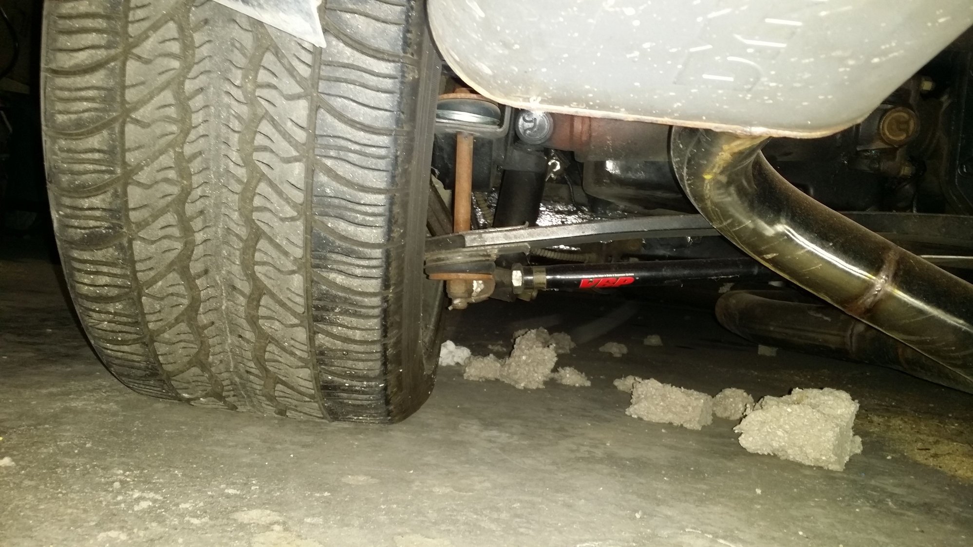

I've got 18x9.5 inch rims on the back and 17x8 on the front, Tom's offset trailing arms but no body mods and I'm not having any issues.
Rear wheels have a 5 inch backspace..

18x9 spring bolt clearance
