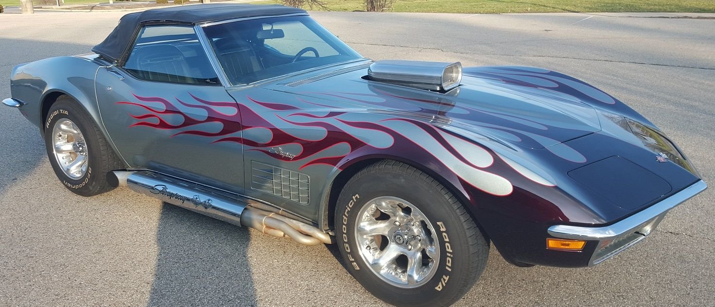

Regarding durability, I'll offer my story:
My car came from the PO with a set of sidepipes. Not 100% sure they were hooker, but looked the part. Problem was they were rusted at the 4 pipes as they entered the 4" collector and it is IMPOSSIBLE to remove that rust without sandblasting. Also, the sidetubes themselves were SWISS CHEESE. Bunch of holes and internal rust.
The PO did the car the "favor" of starting it and letting it putter for 15 minutes every week or two. For years. All this did was get a bunch of water in the exhaust, both in the low points and in the reverse-flow inserts. There it would sit, never getting hot enough to heat the exhaust the entire way through. Awful.
When I rebuilt my engine, I also got a set of BLACK Hooker sidemount headers and sidetubes. The very first thing I did out of the box was COMPLETELY sandblast the factory black coating off of them under the direction of my engine builder. He said that factory black was CRAP and only good to keep the rust off the headers whilst in transit. I repainted with flat black high-temp header paint.
I now have 2 complete summers on the pipes along with an impromptu drive in the rain. I have seen ABSOLUTELY ZERO rust, rust spots, wear spots, discolored spots, or any other sorts of spots on my sidetubes or headers. They look like they were just installed.
Stainless steel is cool, but I've heard two things: First, the 'blue' look is inevitable. Be prepared to like it. Second, I've seen posts on this forum where "Stainless" doesn't mean "Stainless" and that there is some flaking and pitting of the finish happening. I believe this is more with the OBX pipes...I don't recall seeing any particular feedback on the Hooker-brand SS pipes, which can be good, or could mean that folks just don't spring for the extra cost.
Personally, I'd ONLY get the black or the stainless. The plated/coated ones will look good when you put them on the car BUT CAN ONLY GO DOWNHILL FROM THERE. You can't polish them without removing the coating. If you blast and repaint them, you may as well have started with the black ones.
Personally...this is me, here...I'd only get Hookers. I figure they've been doing it since the dawn of time and should have it pretty well figured out. It's an exhaust system and is subject to some pretty extreme stuff.
I have a peculiar issue with my car that made it difficult for me to get a good seal at the head, so I have to run these expensive graphite-insert gaskets that work AMAZING. Simply awesome pieces. Haven't had one stitch of a leak, which is saying something in my extreme condition.
As far as Mr. Leadfoot4's story...dunno. I doubt many of our cars see much rain duty. All I can say is to blast and paint them with QUALITY paint out of the box (if you get black) and stay on top of them if they do show any rust.
And DON'T start your car if you're not going to let it get hot through-and-through. That's good advice anyway, but it is especially kind to your exhaust system.
