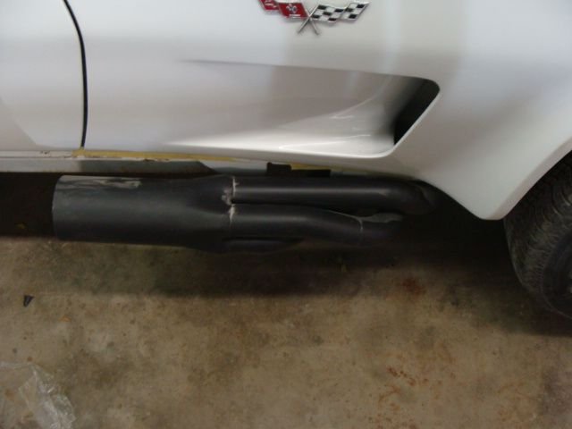

This is the side exit on the Billy Boat headers. Quality construction, thick mounting flanges, and they fit perfectly. These are the black ceramic coated headers.
