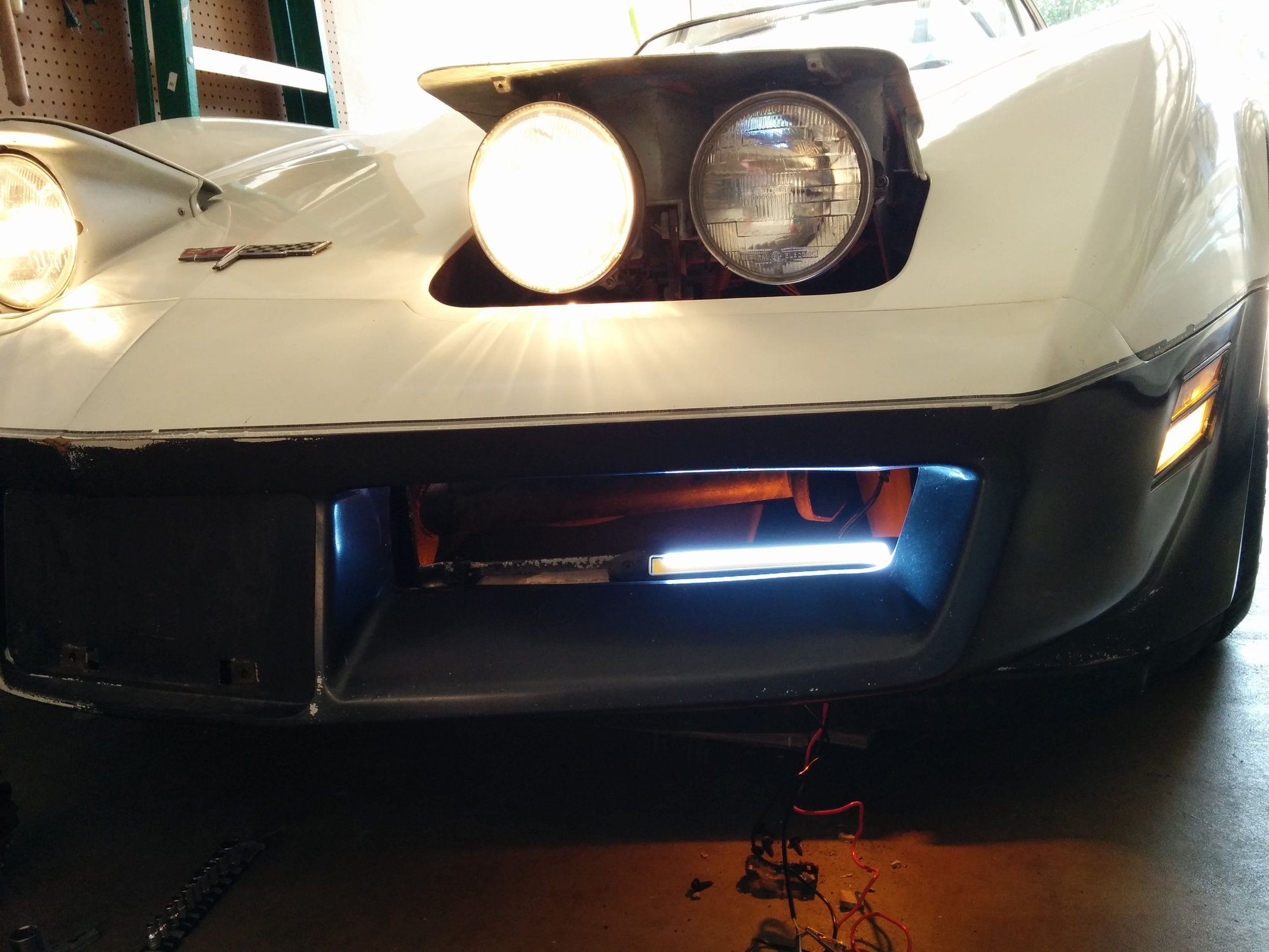

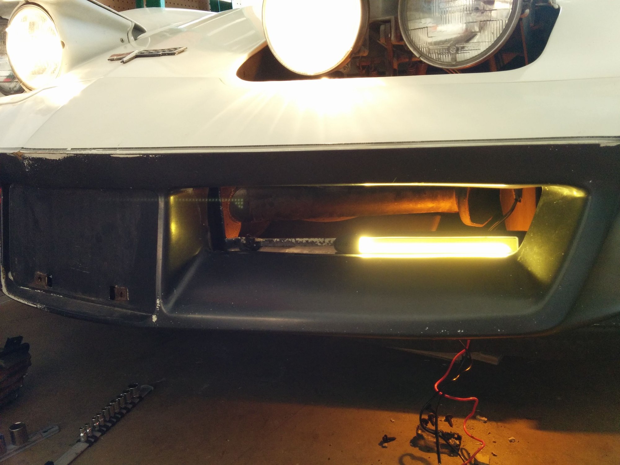

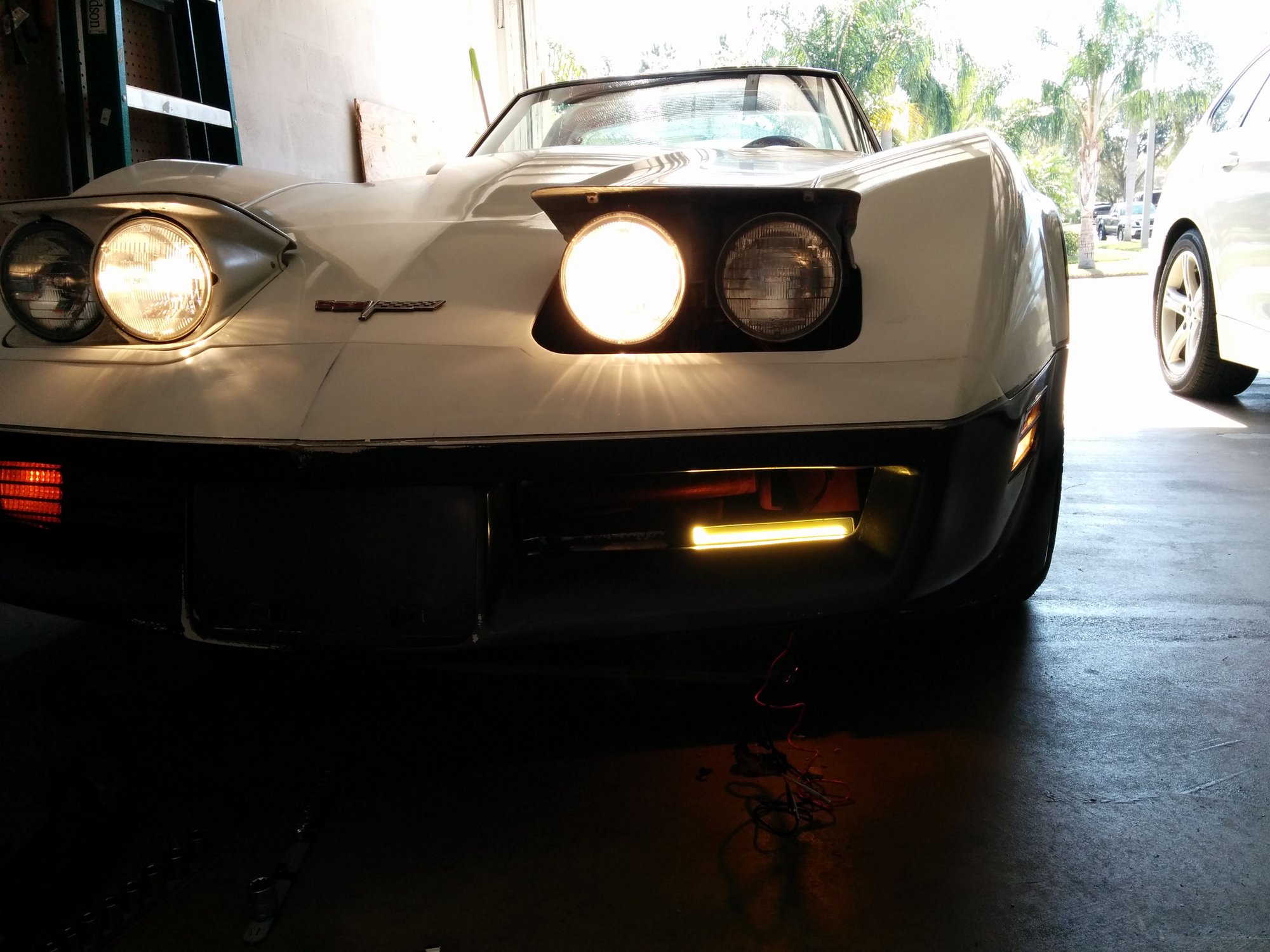

I did some tinkering today to see how the DRL/turn signal would work out. I think I'll sind some sort of frosted cover to soften the brightness some and look for a mesh I can bend into lace to cover where the grille was.
I have the parking light intact behind the bumper cover (why there is an orange glow behind the DRL) which is what I'm using to draw power for right now. Just wanted to make sure it worked properly prior to cutting those wires.
