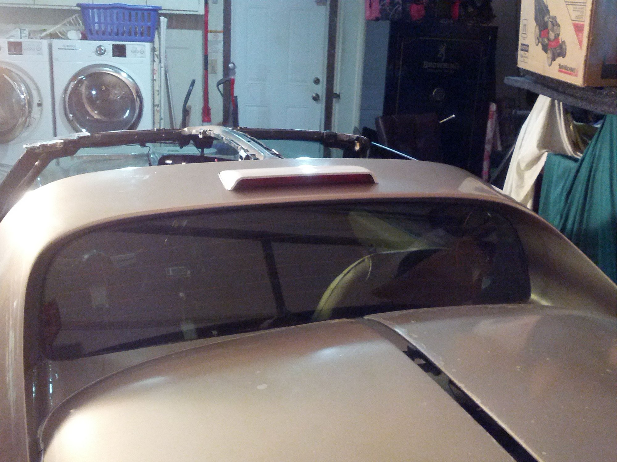

I did the CHMSL from a C4 about a year ago. Found NOS one on eBay for great price. Install was a little tedious and nerve racking since ya have to drill mounting holes. It looks fantastic, is very visible, flows nicely with lines of the car.
I just looked at your thread on this.
That's what I'm looking to do, too...

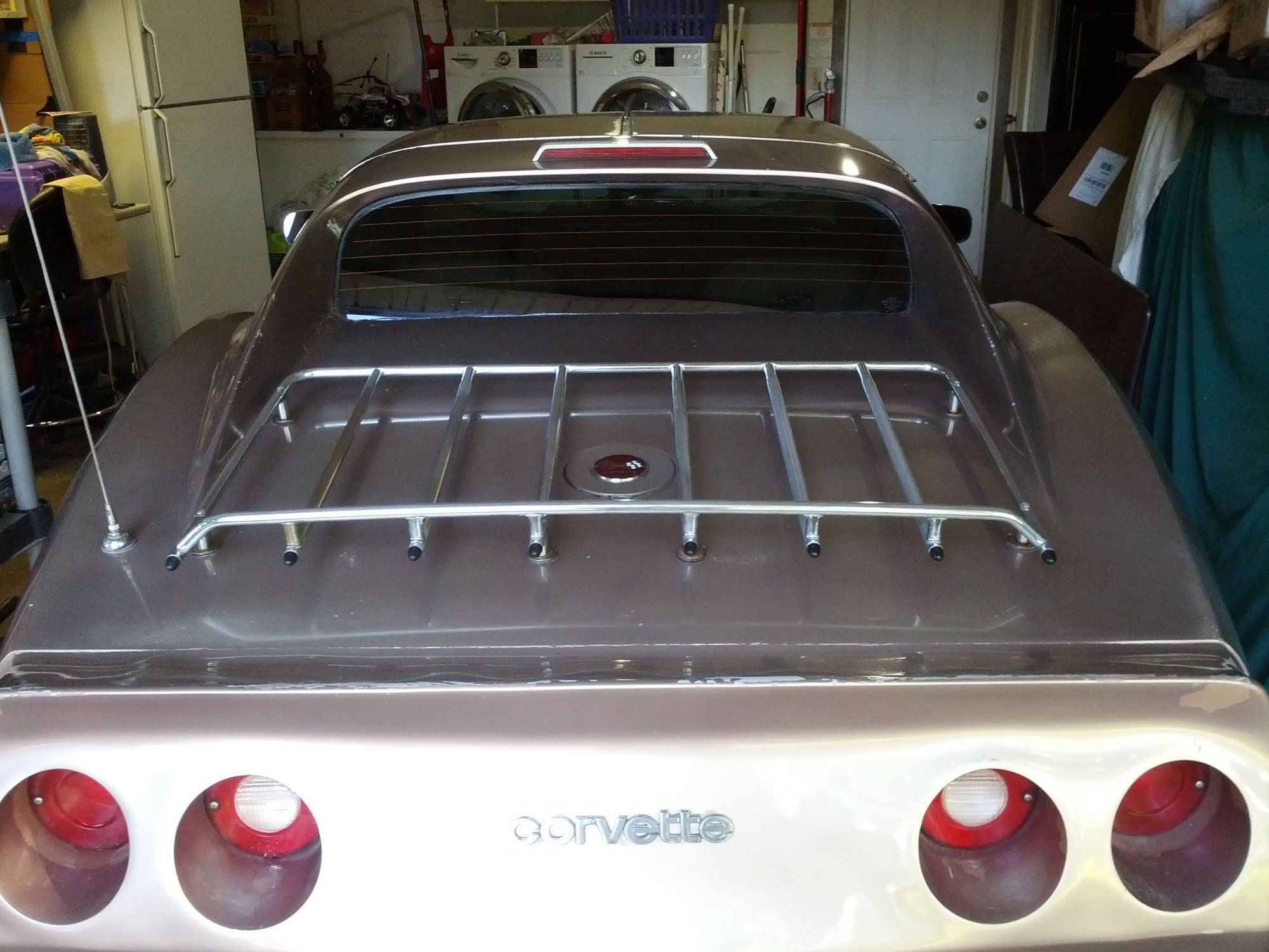

Sorry.. i was on the wrong device before.. here are some pics of the CHMSL on my car. Forgive the garage mess, she serves five different purposes..

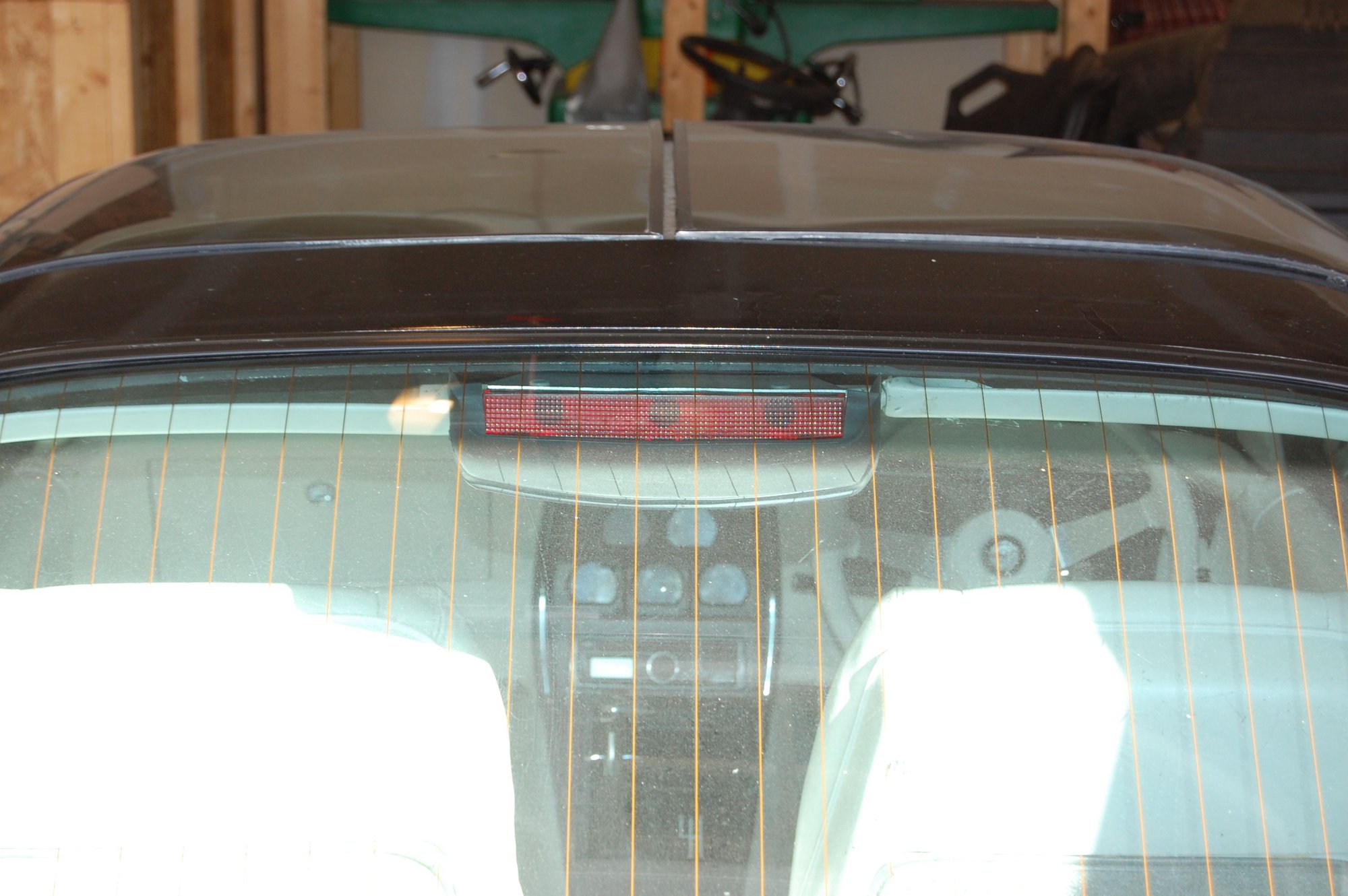

I put one one my "78 a few years ago. I walked through the auto scrap yard until I found one that looked like it might fit inside along the rear window.
after some modification to the interior side trim I ran a wire direct to the brake switch, so it wouldn't blink if I used the turn signal.
And Yes, it is "RHD"

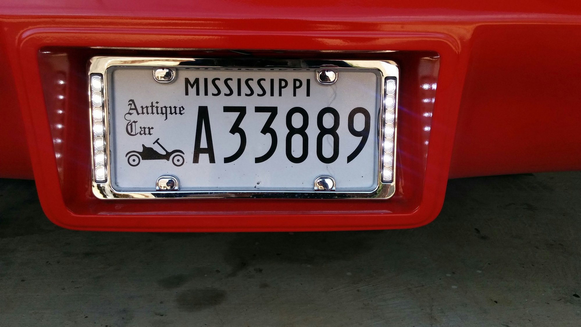

Meanwhile, for those folks that don't mind a little "truck stop accessory shop bling", there are tag frames available with LEDs that can be wired into the reverse light circuit.
