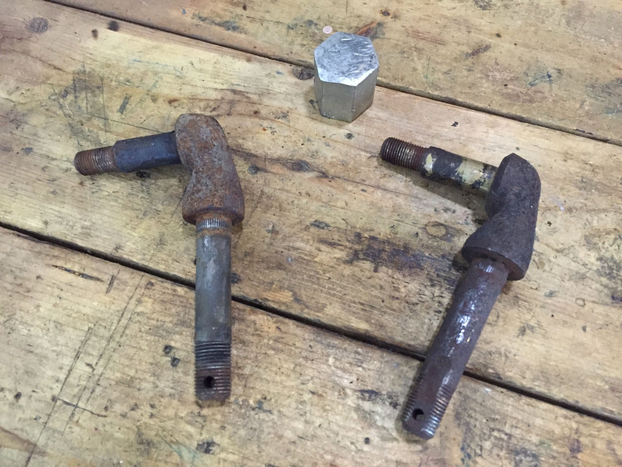

Well I finally got both mounts out! I broke down and got the removal tool. $15 bucks but worth it. Soaked with PB blaster for couple times first. Passenger side came out with 3 or 4 good shots with the heavy hammer. Driver side was a different story. Had to apply heat and lots of hitting. After about an hour it budged. Then presoaked with PB blaster some more and few more hits and it finally popped. Probable could re use them but got new mounts. Threads unharmed. Now for new strut rods.

I read on here last spring where folks were using 3/8" (if I remember correctly) black iron pipe caps in place of the special tool. I picked one up from the local home improvement store and it worked for me.

Yep...the pipe cap alternative good. I've also read some use mount nut to pound on. I knew it was gonna be a tough job so I wanted every edge. I was really more concerned with damaging the ears on trailing arms. The tool is a good solid piece the takes most of the impact and threads deep over the stud surface. But whatever works. Basically posted this for use by others taking on this repair.

Regardless of what you choose for the job, the purpose of the removal tool is to protect the threads on the mount and to keep you from mushrooming the head when you pound on it driving it out.
