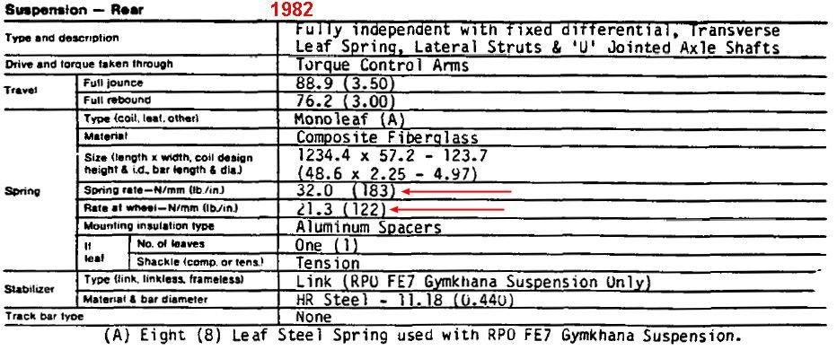

Thanks, I didn't know about those archives until now. Unfortunately, they don't answer my questions about these springs.
The first image below is from the '82 spec manual. It shows the spring rate as 183 lbs and the rate at the wheel as 122 lbs. Looking at an earlier '72 C3 (second image below), it's listed as 85 lbs at the spring and 121 lbs at the wheel. How can they be almost the same at the wheel, but so different at the spring? And how is it possible for a Corvette to have an 85 lb spring?? I'm obviously not interpreting this info correctly.

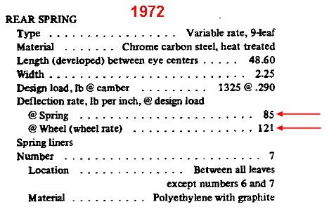

Well, I looked up the '71 to see if the 85 lbs at the spring for a '72 might be a typo. I was thinking maybe they left off a "1," and it should be 185 lbs. However, the '71 is rated 140 lbs at the spring, and 123 lbs at the wheel. That didn't help one bit...
To 81 - why monospring or leaf spring?
A Spring rate is NOT a spring deflection rate....these 2 terms are different. The spring rate is the force to move the spring 1 inch. The spring deflection rate is I believe the amount of weight the spring is designed to carry when deflected a certain height....They are NOT the same.
Most C3's as stated earlier and again now had way too soft steel spring rates IMO and the composite were VERY soft as well giving an extremely cushy soft ride. The base suspension steel spring on 78 C3's was 192lbs....very soft in an effort to preserve some semblance of decent ride with the raw characteristicss of a steel rear spring. A composite allows MUCH higher spring rates with minimal losss of ride quality (my 360 composite rides 10X better than the OEM steel Gymkhana 292 lb spring) and superior suspension control.
The second picture above for your 72 does not give you a spring rate but a spring deflection rate which is not a spring rate...I am sure some engineers can convert the number for you with the right information and equations.
The source I gave you conclusively verifies that the composite 81/82's had extremely soft rear springs...I believe the composite 82 gymkhana was a whopping 198 lbs which is Cadillac soft......
I may go to a 420 composite with my 550 front springs if the rear 360 ever "wears" out (it won't) or splits from severe duty or road damage (maybe some thing will happen). I spend some much time on certain topics since after 33 years of C3 ownership and lot of experience with certain components on these cars, I try and keep the record straight and prevent misinformation..
Hope that helps!
