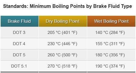

Just so you understand, the only difference between DOT 3, 4 & 5.1 brake fluid is the boiling point. They are ALL glycol-based brake fluids. Glycol based fluids are hygroscopic, which simply means that they attract and hold water molecules from the surrounding environment.
Most all DOT 3, 4 & 5.1 fluid sold these days is labeled "synthetic". This doesn't change the fact that they are glycol based and consequently hygroscopic.
DOT 5 brake fluid is silicone based fluid, not to be confused with "synthetic" brake fluid. Silicone brake fluid is non-hygroscopic, it does not attract water. This is the major advantage of silicone (DOT 5) brake fluid. It is particularly suited for hydraulic brake systems that do not see regular use. The Department of Defense switched much of it's rolling stock with hydraulic brakes to DOT 5 (they purchase it in 55 gal drums) back in the '80's primarily to reduce recurring maintenance, for which it has proven very effective.
There are some significant differences between glycol based brake fluid and silicone brake fluid. Depending on how you use your vehicle, one or the other may well be much better suited for your particular use
Good luck... GUSTO
