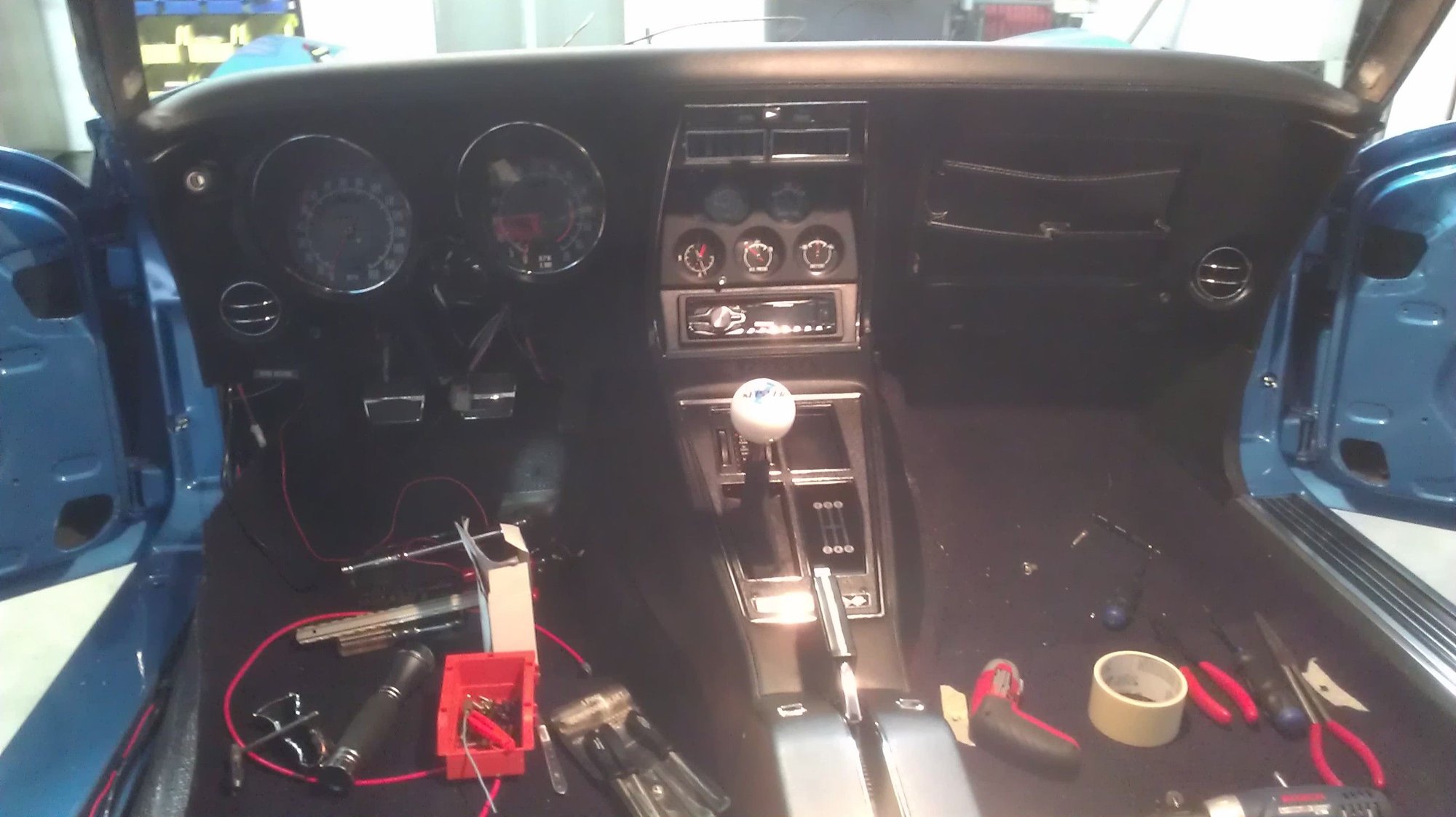

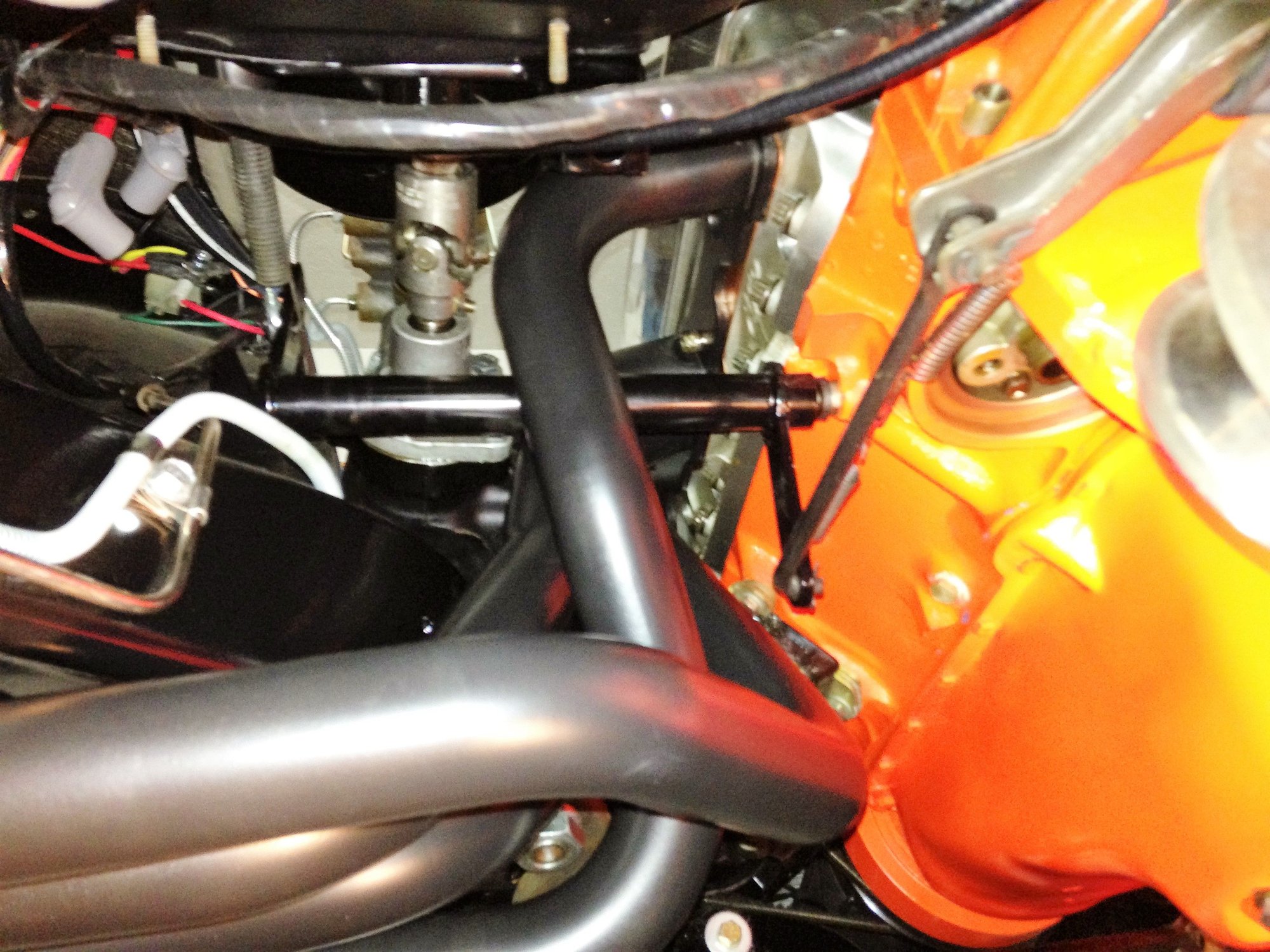

Here is my install notes. (t56 Magnum 6 speed)
https://www.corvetteforum.com/forums...-corvette.html
Contact SilverSport (forum member) they now have complete 5 or 6 speed kits.

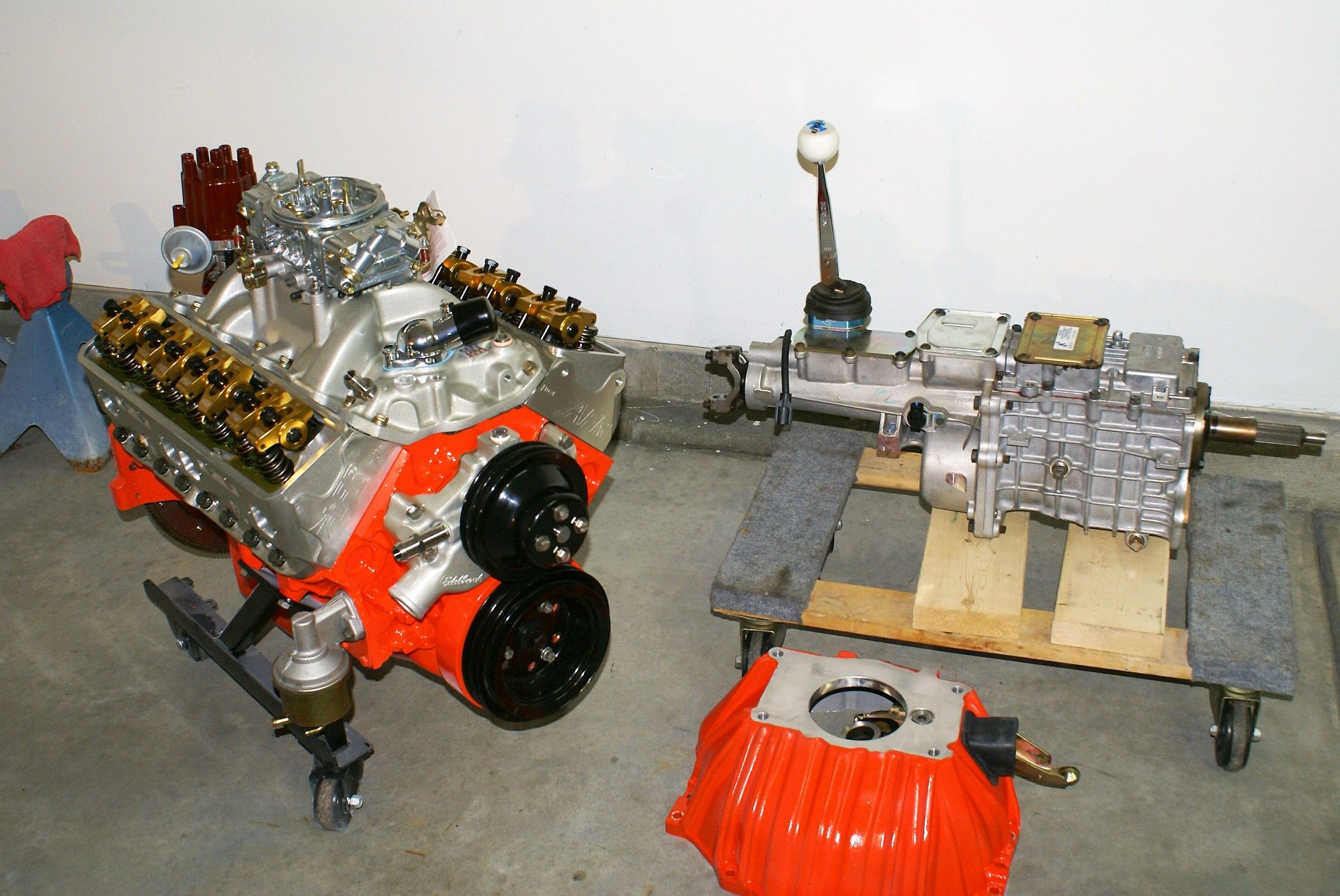

Here's a thread I did on my swap from a 4 speed to a T56 6 speed out of a 94 Trans Am.
https://www.corvetteforum.com/forums...-s-list-8.html
Nice vette! Good luck with it
