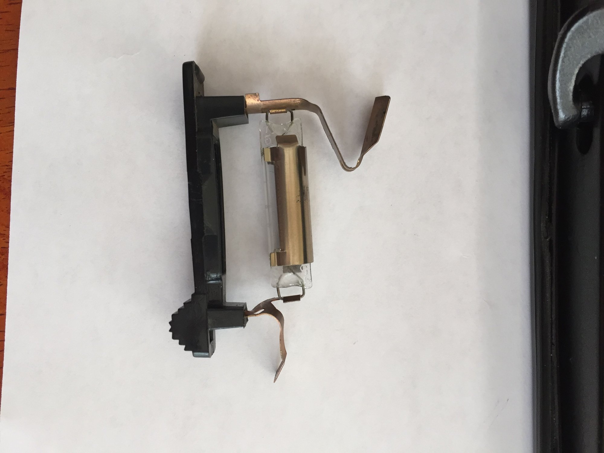

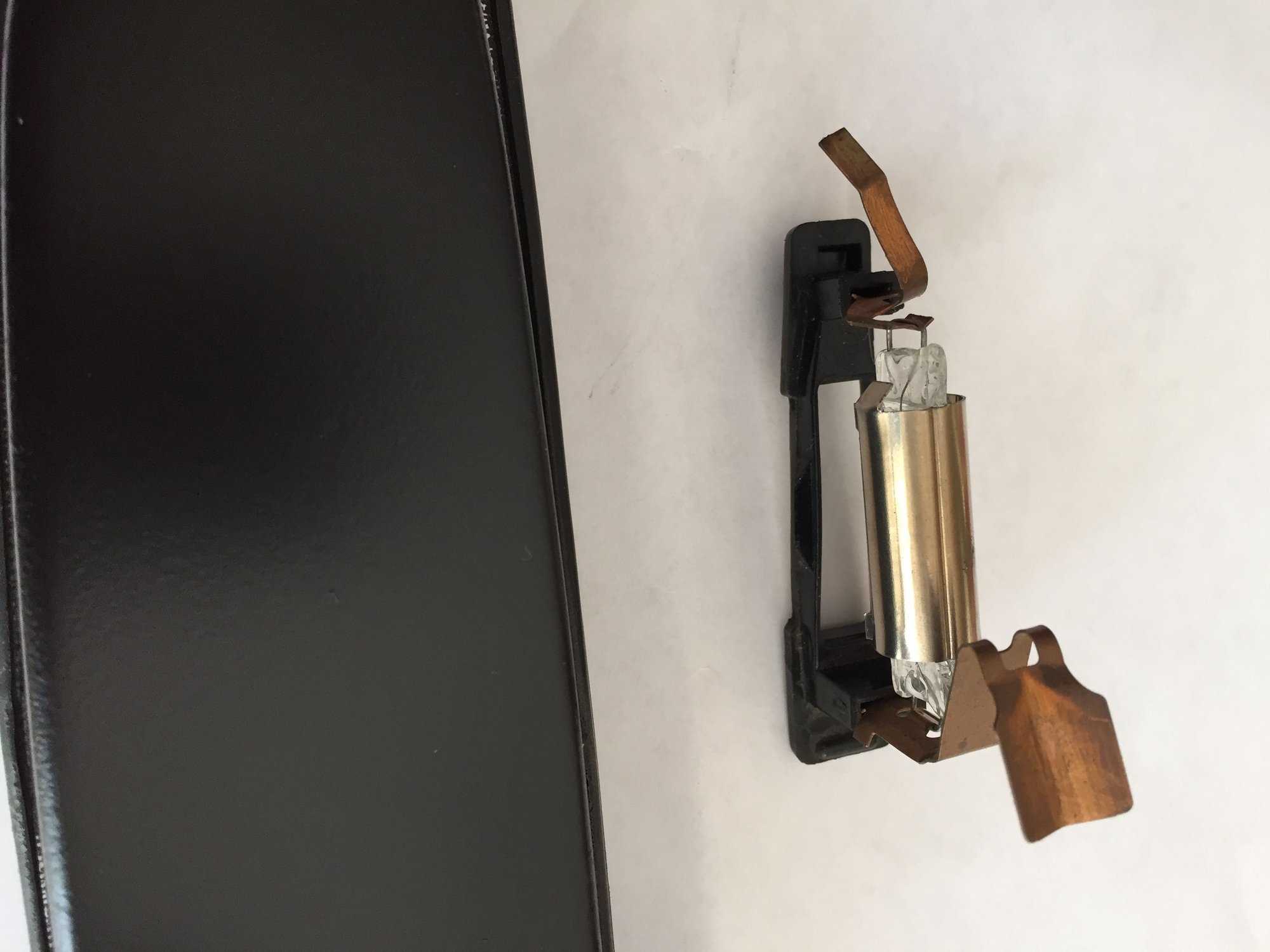

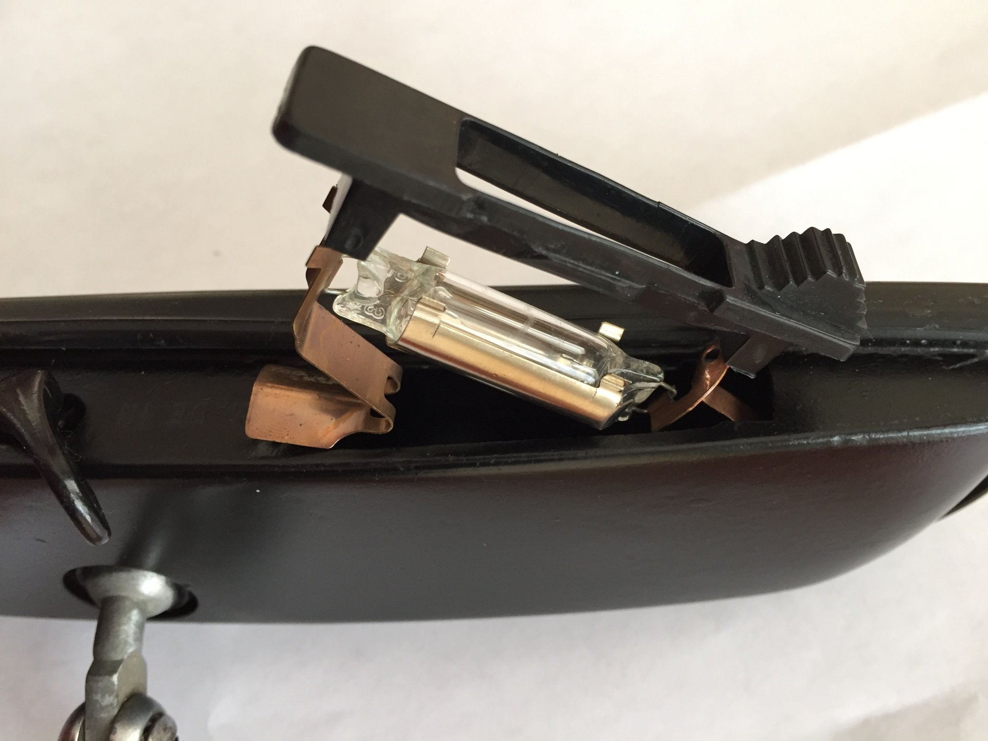

The map light is a very touchy design. I agree with DUB that it would be better to use an LED. The general idea is the hot goes to one side of the bulb and when you slide the lens to the right the other side of the bulb is grounded.
I would post a WTB in parts and see what you can find.
Here are my pics:

Is the metal on the thumb slide end supposed to be bent at the angle in the photo's?
