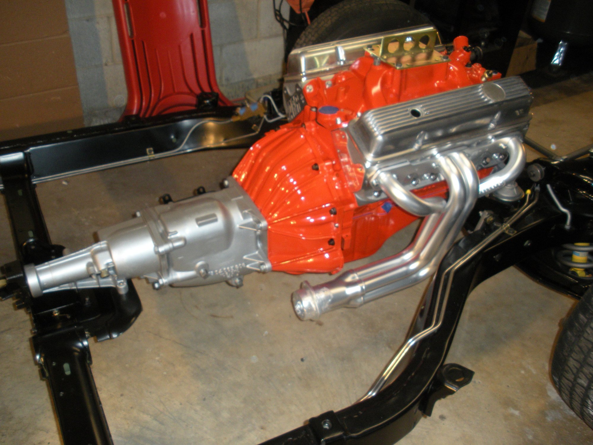

I put Hedman Elite Thermal coated header on my 77, and the yfit great. No clearance issues on the Steering box or my heavy duty idler. Good thick flange for no leaks. For different unrelated reasons I decided to go with Stainless Works headers, and they are even better, but are much more expensive. They also fit with even greater clearance on the idler arm, and use slip joint flanges IF you use their exhaust system. My Hedman Elites are on the C3 Parts for Sale section if interested.

Originally Posted by colesweat
Are those block hungers?
No, these are Hedman Elite long tube headers with 1-5/8 inch tubes into collector. Made for 2-1/2 exhaust pipes. I have other pictures added.
