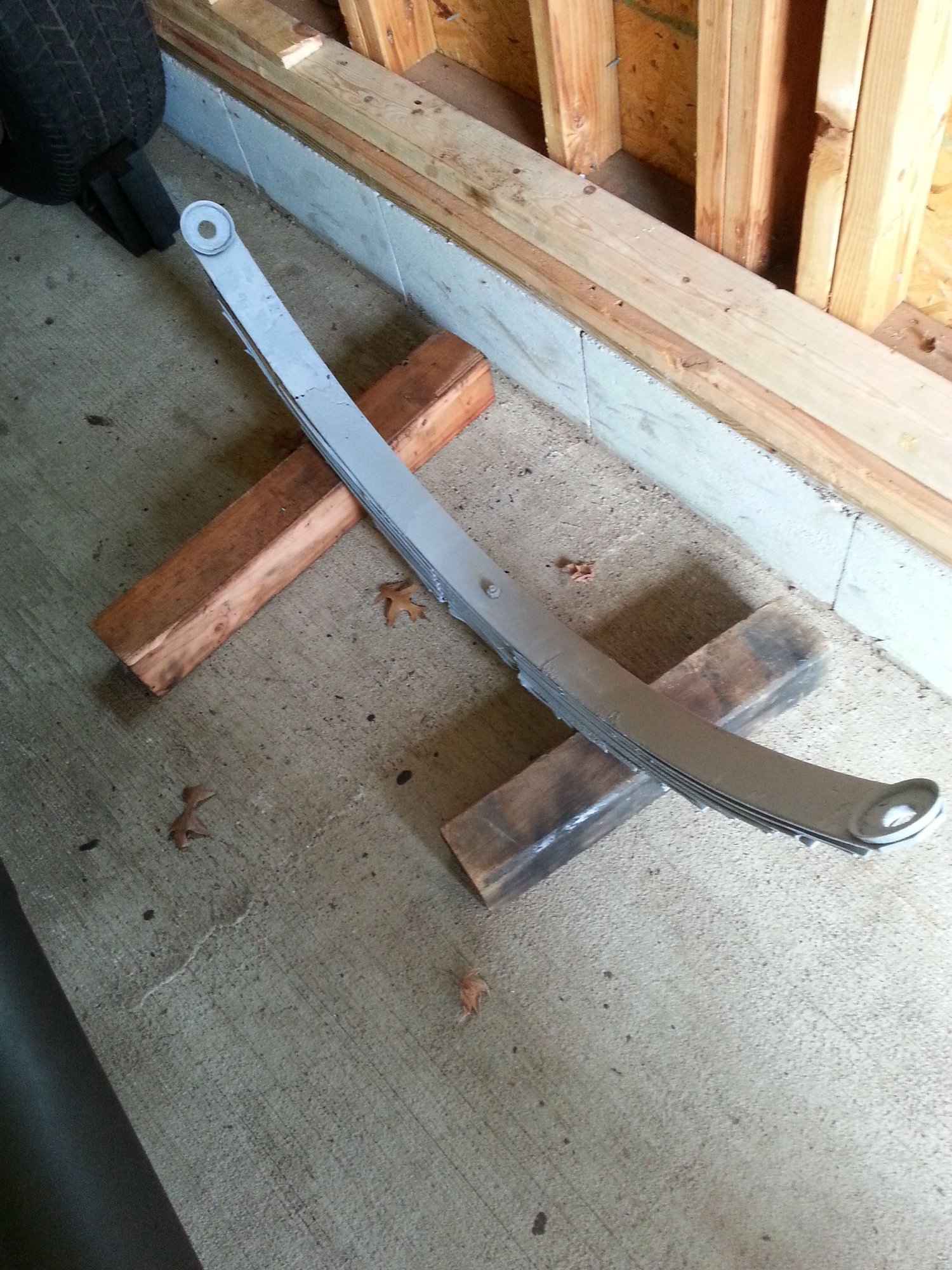

Here are a few pics of my leaf spring. I painted it with Duplicolor primer gray which I felt it was the closest color to factory stock. It just doesn't look good. Mainly because of the liners. They look aweful. The liners are black but my research showes that the leaf spring was painted gray at the factory AFTER the liners were installed. This means just painting the entire leaf spring gray should suffice. I painted it and to my eyes.. it looks like crap mainly because of the liners. My option is to take it apart, buy new liners, clean up the exposed leafs as much as possible and respray it gray. But... do I really want to take the time and effort to take apart a 37 year old original leaf spring even if it doesn't have any structural issues. IMHO.. it can't possibly be better than ANY new replacement spring whether its steel multileaf of a fiberglass or composite mono leaf.

You're right, it can't be better than new, but, new can be worse than the old. Think about all the post on here asking why the ride height is so high on the rear of the car. The kit to rebuild the springs is less $50 I think.

If you decide to go with a composite, pass on the TRW- too many stories about high ride height. I've seen the photos and it's not pretty. I got a VBP composite and even with that one I had to use most of the 8" aftermarket bolts to get ride height where I wanted it.
Many years ago I cleaned my factory spring and repainted it in black. It still looked virtually new when I took it off a couple years ago. If you're happy with the ride height and don't want to lose weight or get a better ride, if you clean and paint it well you could keep your current spring and save a fair bit of change for something else.

I replaced the liners on my '72 and painted Grey
Looks OK to me
Not as Nice as Alan71's !!!!!

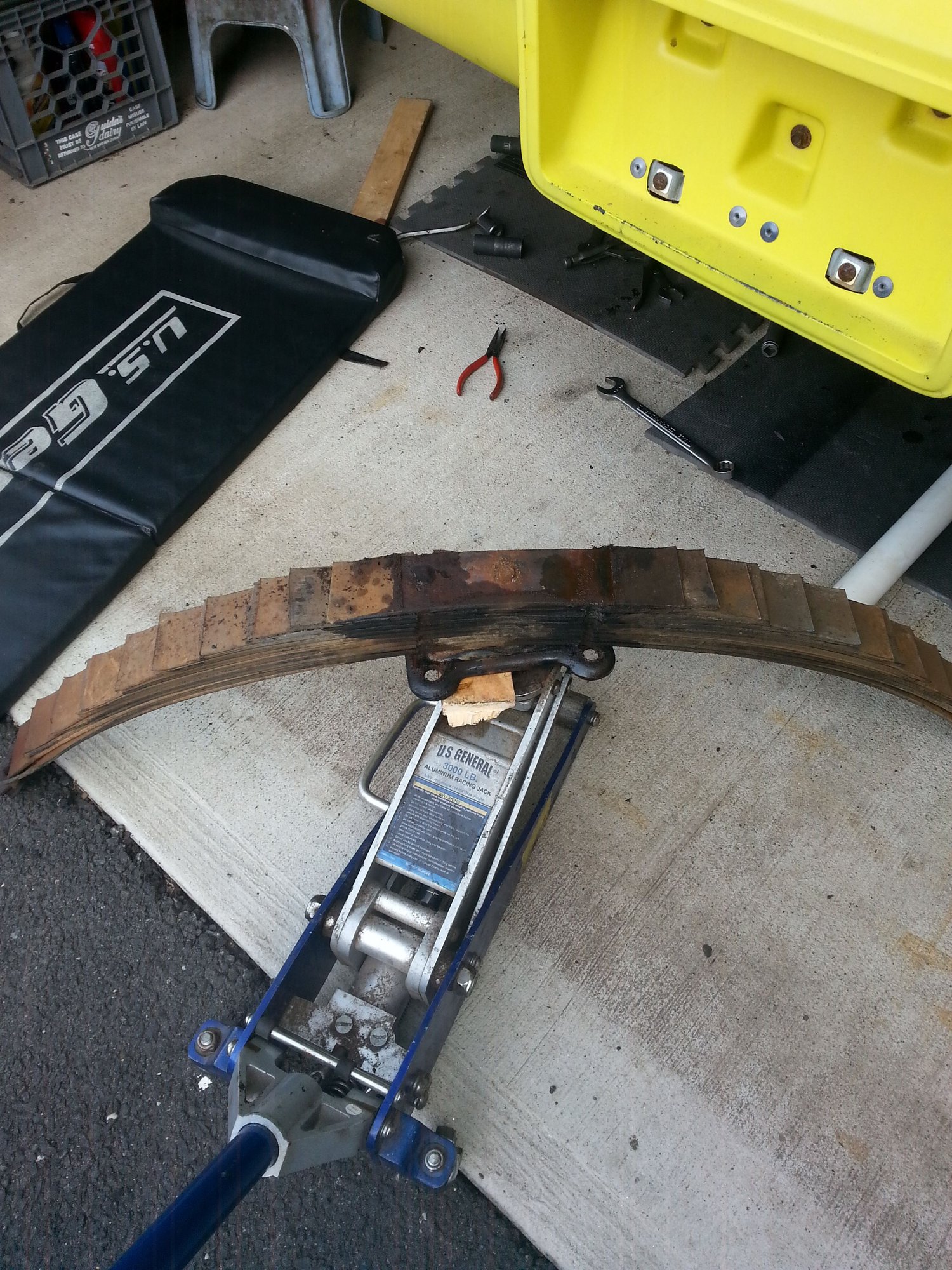

I took my stock original spring apart (its 10 leafs btw...) and tried cleaning it up. What I found on some of the leafs was some fairly significant rust. It didn't eat into the individual leafs that much but it did a little. Also... the cups at the end of the longest leaf are really in poor condition and will never clean up enough to look good. On top of that... I need to replace all 4 bolts (they are all rusty and look horrible) that attached the spring to the differential and the main bolt that holds the entire spring together is shot. I think I am better off to ditch this spring even though it had my car sitting perfectly. I don't think its going to last. I don't want to go with a stock multi-leaf spring only because of cosmetics. I like the way the composite looks better. Now I just need to get up enough money to buy one!

If you aren't concerned with originality, I would go with the composite spring. I put one on from VBP many years ago and it is still the single best upgrade I have made to the car. And I've been through four engines and three transmissions in that time. (Can't seem to leave well enough alone.) Still got that spring though.
