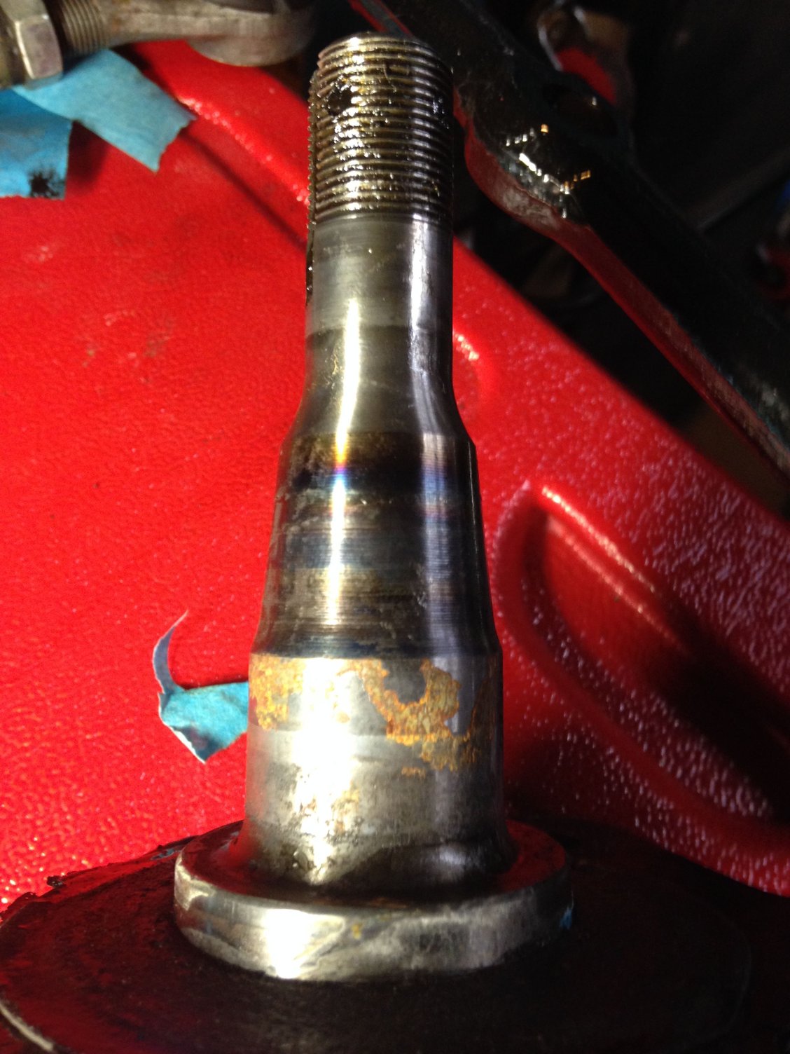

I'm putting some coil overs on and painting the suspension pieces. While disassembling the spindles I found mine to be blue. Do I need new ones? It's a 1968 by the way.

48 year old spindles. In 1969 the corvette received a larger diameter spindle, hence bigger bearings and different hub. 68 and older are classified small bearing cars.
Coilover install gives me the impression you are going to do some spirited driving. When in doubt you could have yours magnafluxed. If there is any bearing scoring, replace. Is the discoloration I see corrosion? T

I'd have them checked somewhere. The blue is from heat.
