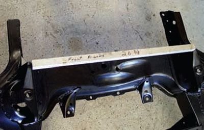

Where the control arm shafts touch the frame
From Van-Steel
