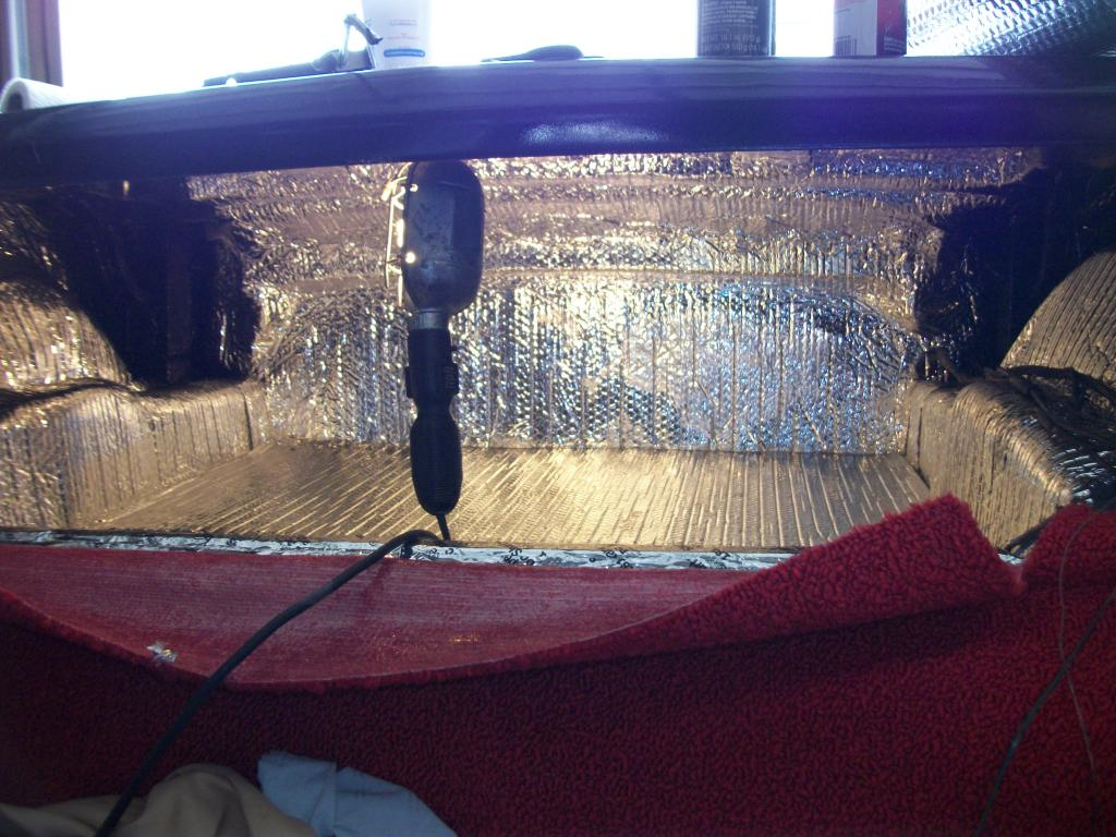

Here are a few sample temp readings: Ambient air was 80*F/entire cabin has been insulated with reflective heat/soundproof HVAC blanket..........
Steering Box by Exhaust manifold 160* F
Steering column at Firewall 130* F
Steering column inside car by gas pedal 110* F
Steering column at dash mount 98* F
Steering column at steering wheel nut 90* F
Exhaust pipes under footboard 300* F
*Footboard inside the car 95* F (Entire interior of car is insulated/soundproofed with economy-grade Foil-backed heavy-duty bubble wrap)
Exhaust Pipes under the floorboard 250* F
*Floorboard interior 95* F
The steering column transfers a good amount of heat.
Before insulation was added the heat coming from the firewall and floorboard was nearly unbearable.

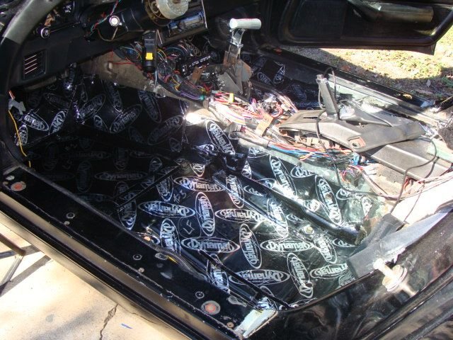

I studied most of the threads here on reducing cabin heat on these cars. My car has been down for a few months for repairs. In the mean time I installed the heater shut off valves in the heater hoses. I also installed Dynamat Xtreme and Dynaliner to the floorboards. It gets over 100 degrees here many days during our summers. I can't wait to see the payoff of these modifications.

Street, the dynamat will help with noise but is not designed with blocking heat in mind. It will to some degree due to it's additional mass that is added to the floor pans but the heat will still soak through.
I found refletix to be effective at combating the heat soak. I have fat mat mega mat on my floorboards for noise then the refletix on top of that with 3m spray adhesive, then the stock jute and carpet on top of that. works very well for staving off the heat.
That with the c4 fan added and electric cooling fans (condensor cooling) makes my cabin as cool as I want, even on 100* days.
I have "Dynaliner" installed over the Dynamat Xtreme. This should help with the heat issue. I need to correct my post.
