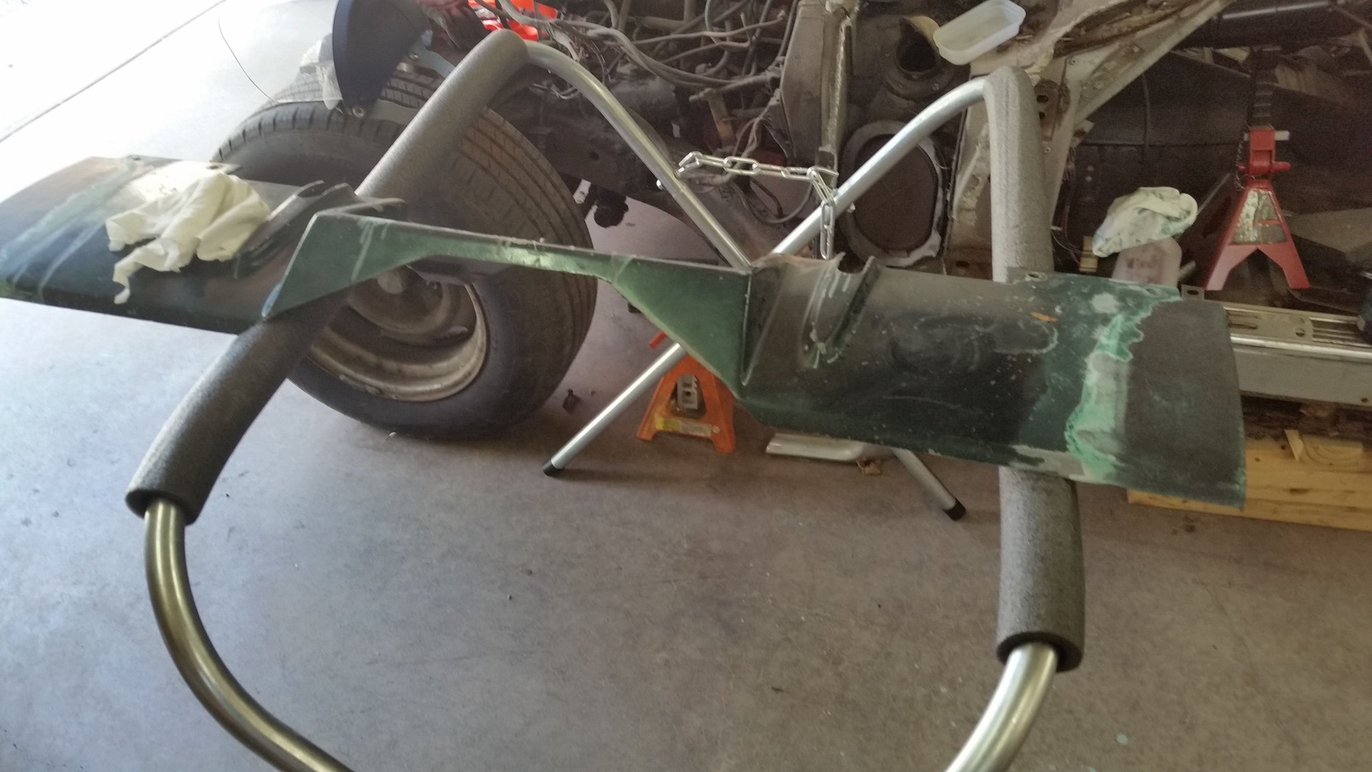

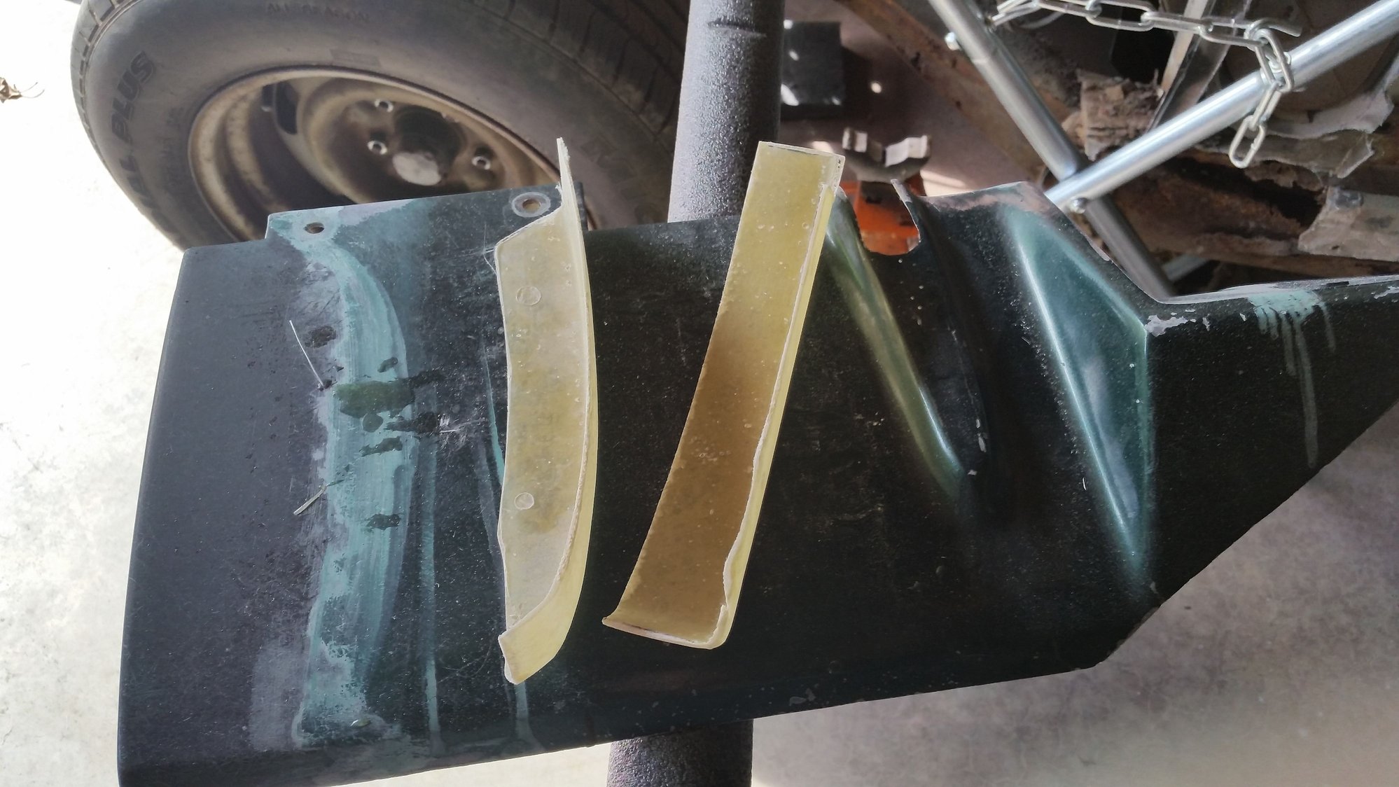

You can find side pipe valance's on Ebay or in the parts section. Its no to hard to make the needed flanges to connect the valance to the quarter panel. Then some small glass work and paint.
Here I 'll show you!
RVZIO
When you get the valance, prep it and make glass molds. Then reverse the mold and attach to the car. Some VPA and you are done.
Good Luck, it all depends how much work you can do.
RVZIO
