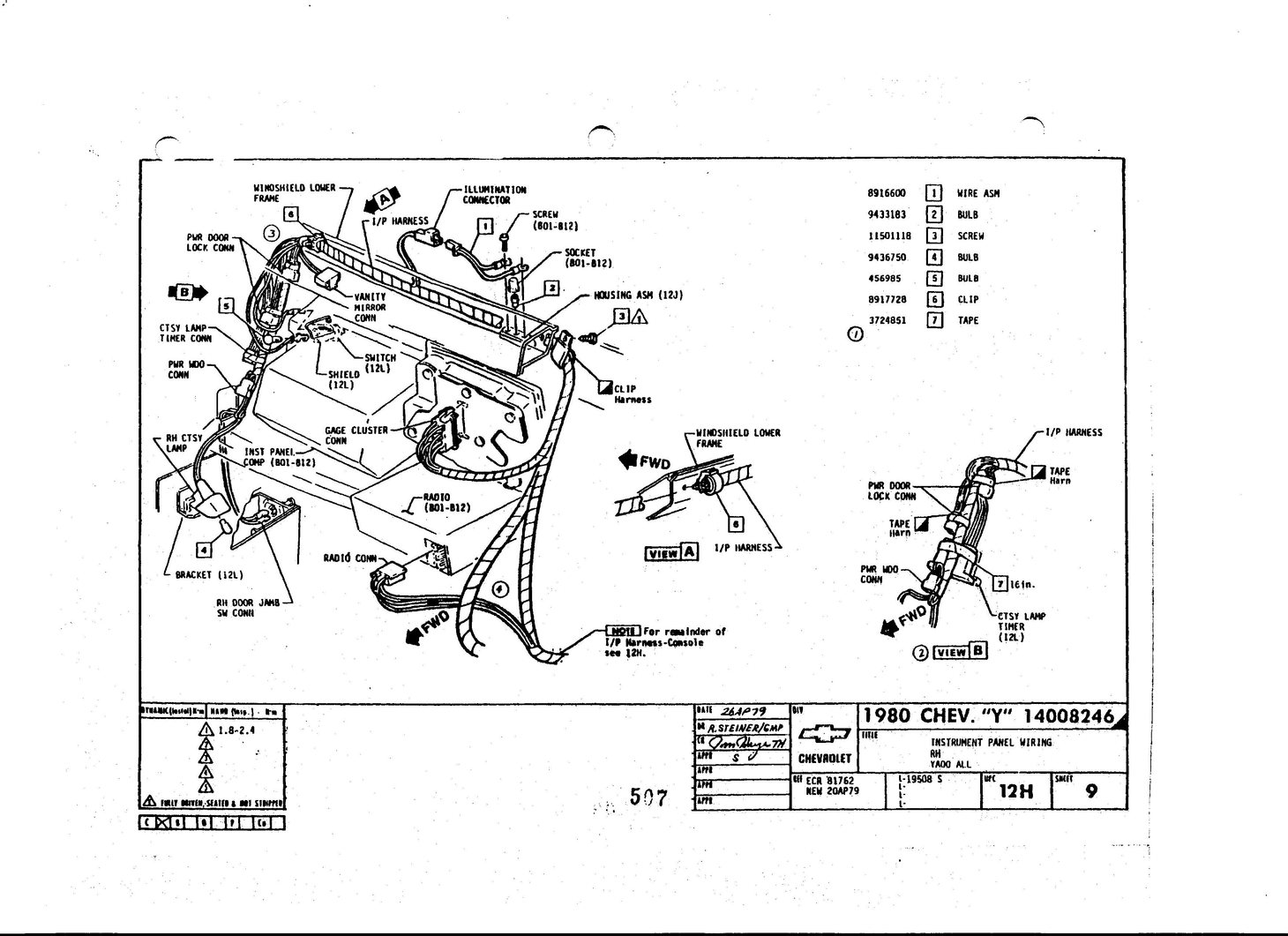

Here's the page from the assembly manual. Notice "Illumination Connector" at the top.
You may be missing the little wiring harness (item 1).
The bulb socket is a slightly larger version of those used in the cluster and gauge pack.
