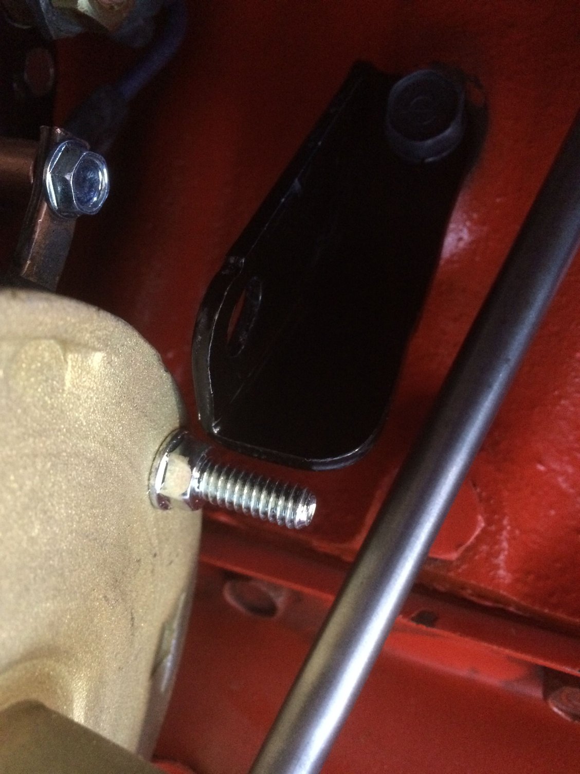

I'm trying to install the starter brace on my 427 and it doesn't reach the stud on the end of the starter. It's a GM part and doesn't even come close. Could the starter be the wrong one? Thanks in advance.

That almost looks like a SB brace rather than the BB style.
I think the starter stays the same so it's not likely that another one will be different.
Here's my 72
Thats a better picture, can you compare the bracket to the plug in the block against yours?

The brace that I have is a bit shorter than the one in your picture. I did some checking and there are 2 braces for a 427. I must've ordered the wrong one. I ordered another and I'm hoping it fits. Thanks Mooser.
