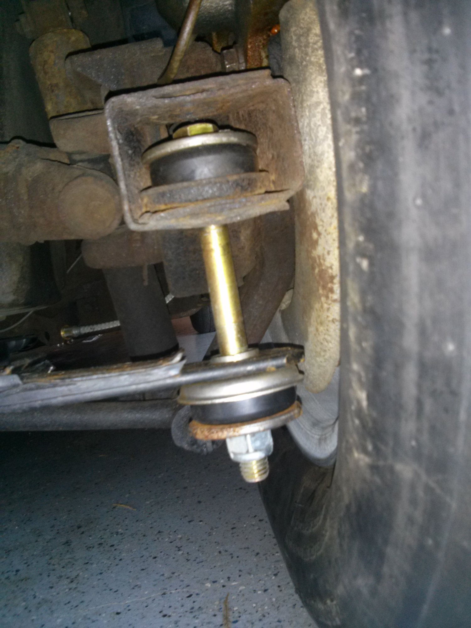

thanks for all the pics. Here is a pic of the clearance I have between leaf spring and wheel
