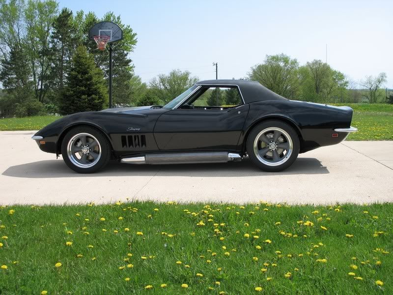

Kevin, you might ask folks to post pictures of wheel combinations that they have on their Chrome Bumper'd cars to give you some ideas. A lot of folks do seem to like the classic looking wheels (even in the larger sizes) on their Chrome Bumper cars. The good news is that the aftermarket is now offering a lot of the old classics in the larger wheel sizes.
I tried to post a picture of a beautiful 1969 (unfortunately it's not mine) however the Forum isn't allowing me to post right now...
Looks like it's now working... these wheels appear to be 16's or 17's.
Good luck... GUSTO
GUSTO[/B]
I'm pretty sure in a previous post the owner said they are 17s and 18s.
If I remember correctly 17x8s with 245/45-17s and 18x9.5 with 275/40-18s.
A stunning C3 by the way.
