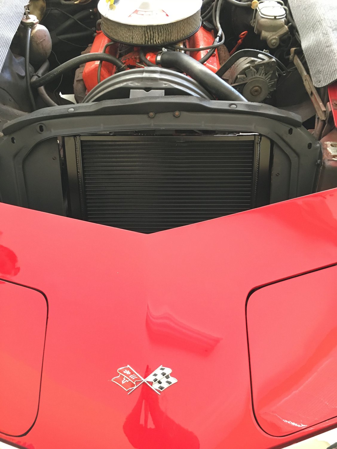

New one in.<br ><br >

From what I see in your picture I think you can do it with the core support in place.
I leave the 2 lower shroud supports off the shroud until it's in place and also rotate the shroud as it's slipped in place.
I do it by myself which takes some extra planning, but with 2 people it should be fairly straight forward.
Protect you radiator with cardboard until your almost finished.
Regards,
Alan
The radiator sitting in the 2 core support brackets.
The 2 lower shroud brackets back in place.
