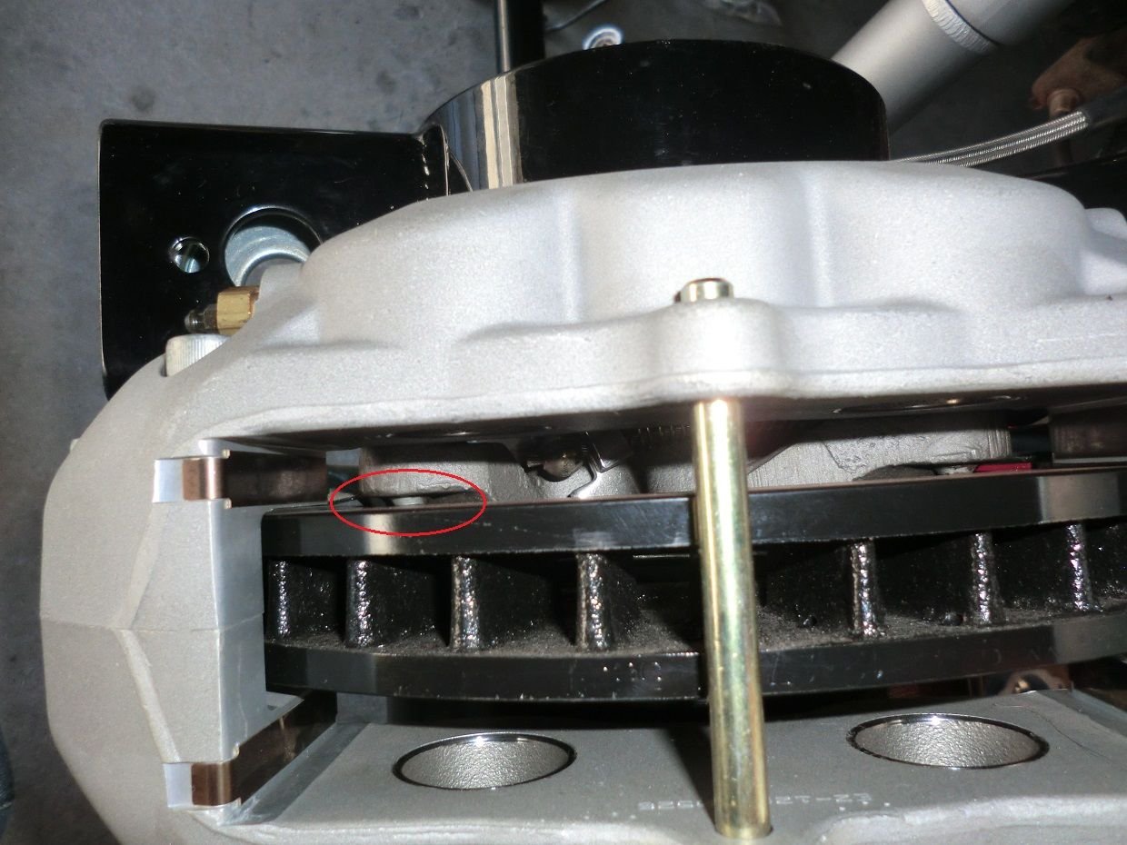

Originally Posted by Todd TCE
As mentioned elsewhere it is necessary to remove the rear caliper from the bolts and bleed it in the vertical manner to purge it fully then refit it to the knuckle. If you failed to do so that would be a significant air in system issue.
I also had to shim the rear calipers to center over the rotor and keep the mounting bolts from bottoming out on the rotors.
You can see on this pic why the caliper needs to be removed for bleeding. The bleeder screw is located too low to allow the air to escape.
Both of these issues would be easy for Wilwood to fix but I guess they don't care.
