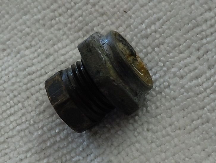

I was draining the radiator on my 76. Turned the drain plug and it broke right off the radiator. Can this be fixed?

Ah, you failed to use two wrenches so the brass bushing that was soldered into the tank is now un-soldered. It can be re-soldered but you'll likely have to remove the radiator to do it.

Ah, darn. Thanks. Yes, I only used one wrench. I imagine I could never solder it on the car because of the fluid in there. NFE (nothing's freaking easy)

Bumma! Pull the radiator.
