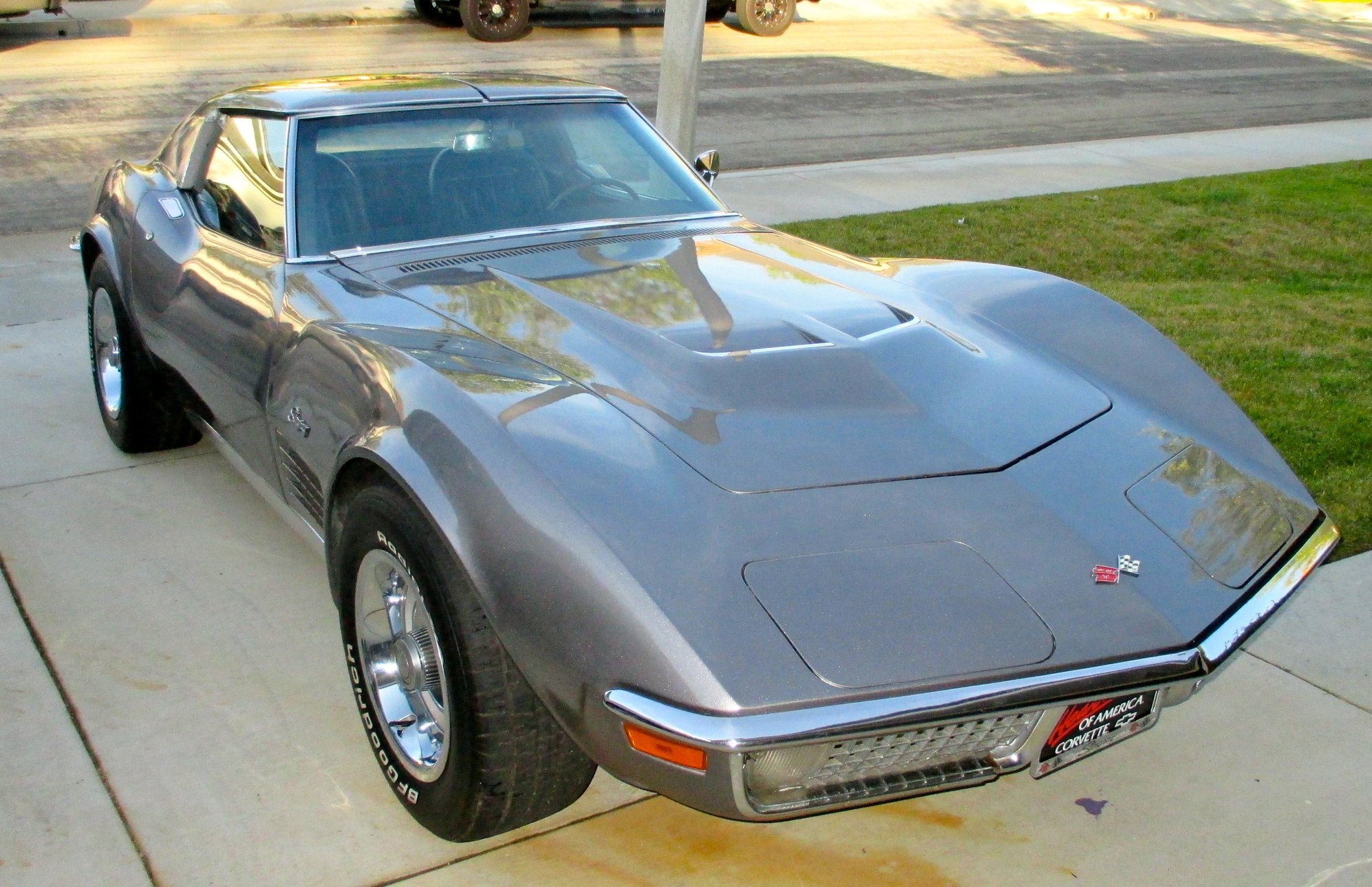

Hello All,,,, I am the new owner of a 1970 Corvette. An L46 350/350, Muncie M-22, numbers matching. Mostly original. From what I hear, its a rare car. The Headers and exhaust are in need of replacing. I would like to keep it as stock looking as possible, while getting the best performance. Any suggestions would be appreciated.
