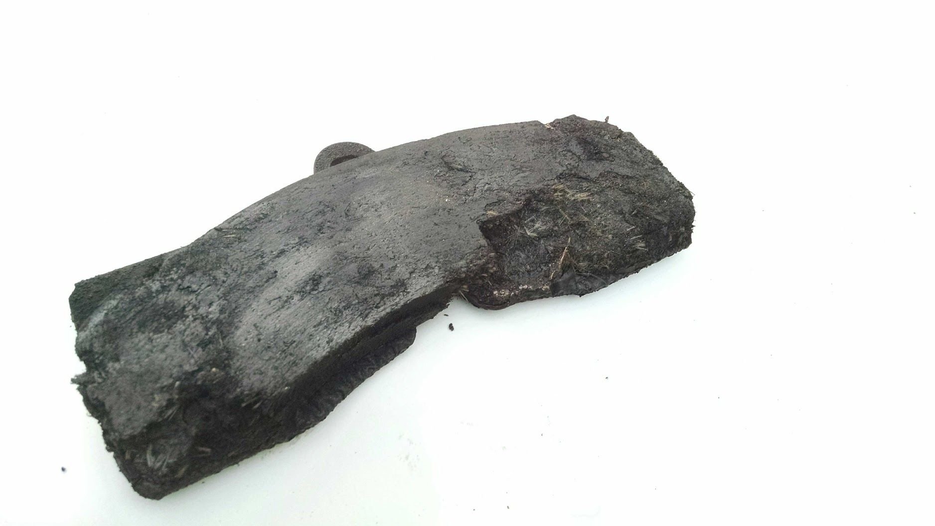

The front, as it turns out, was about as bad as you can imagine. The pads looked and felt like a sponge glued onto a piece of metal and fell apart as you touched it.
The calipers were not much better and some pistons were completes stuck.
So, after replacing ever piece of the system besides the hard lines, prop valve and rotors, I have stopping power!
