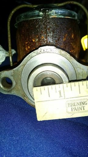

Manual brake M/C has a 1" bore.
Power brake M/C has a 1 and 1/8" bore.
Deep and shallow hole:

My vote is for the wrong master cylinder. It sounds to me like you are just not generating enough pressure in the braking system. GM used the same casting for most of their master cylinders in those days. They just bored the casting out to different dimensions for different applications. I'm betting you have the wrong one.

So the MC is off and it is a 1" bore with a deep hole. That sounds like a manual MC from what you've all posted. Other thoughts?
