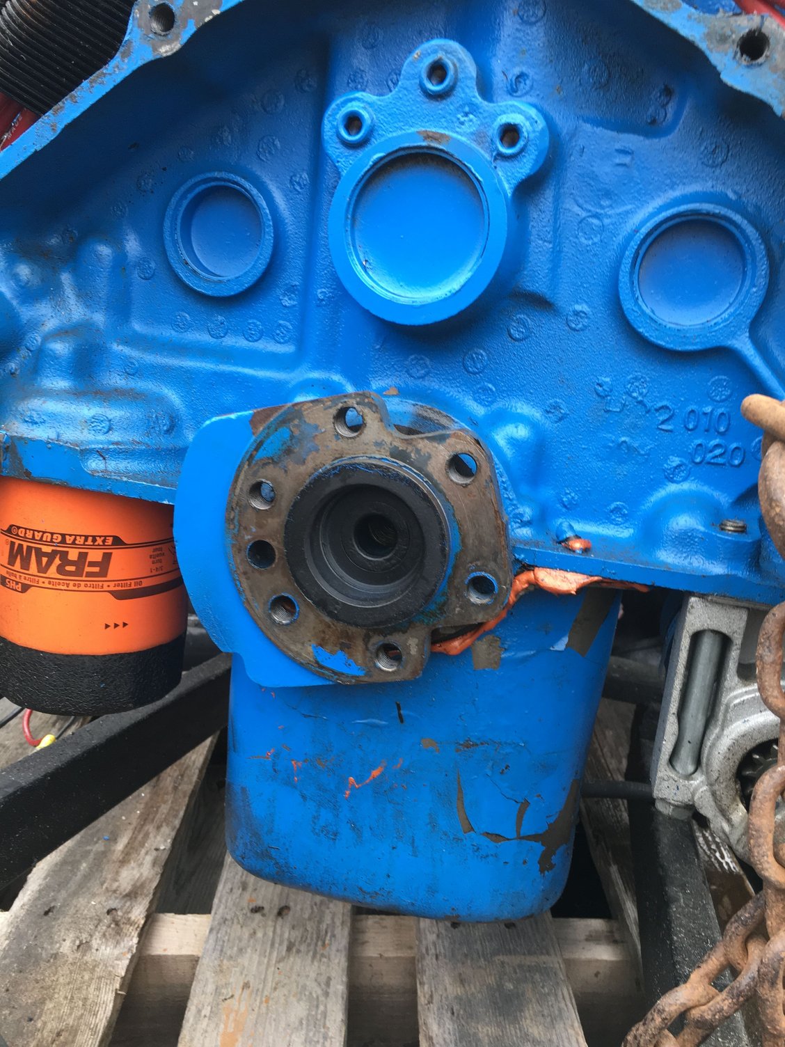

Well then you're ****ed. You need to know whether the engine is internally or externally balanced. Both are possible/likely for a stroker small block. Only way to determine is to look at the matched flywheel or flexplate that was on it, or disassemble the engine and rebalance/measure the rotating assembly. Sorry to the bearer of bad news...

If I can put my hands on the original flywheel(standard trans) a machine shop can hook me up without ripping the engine apart? Just looking at the pictures I posted would look to be a external balance?

Here the back end flywheel

The flywheel shown in your above picture is neutral balance.
In the last picture, it is unusual in that there is paint covering the flywheel surface which contacts the clutch disk - it would appear that it has never driven a clutch! I've never seen a used flywheel appear like this.
If you want to use this motor with an automatic trans, you need a new neutral balance flexplate with 153 teeth for a motor with a two-piece main seal.

It came out of a boat. So the front damper is where the weight adjustment was done? The motor looks really clean under the covers camel back heads with rollers.

No offense Croaker, but you need to at least have a basic understanding to the questions you are asking. Your situation had been answered multiple times, but you are completely confused on the whole concept of engine balance and flywheel/flexplate.
The forum is here to help, but a basic understanding on your post subject is usually expected. It would not make sense for me, or someone else for that matter, to type multiple paragraphs explaining engine balance when there are professional articles all over the web explaining in detail.
1. Posting a picture of a motor does not identify it as a SBC 350 vs a SBC stroker motor.
2. It also does not identify anything about it's balance.
3. Flywheels are only used on standard / manual transmissions (except boats)
4. There is no "weight adjustment" done after a motor is assembled.
If you want to skip any education on the matter, go buy a "Neutral" flexplate for an internal balanced 2 piece rear main seal small block chevy, and if you don't have the harmonic balancer / damper, also buy a neutral / internal balanced damper. Bolt them both on, bolt up your auto tranny, and your good to go.
