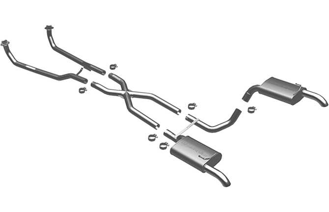

Our 16842 system is 2.5" full stainless, and sounds awesome on the 5.7! You may try some of our vendors here on the forums like Maryland speed, RDP Store and PFYC for pricing!

The only issue with the Magnaflow kit is it doesn't follow the factory path.
If you have changed the rear strut bracket to correct geometry it would have to hang down too far.

Default Doesn't FIt

Hate to ruin your ad, but I bought this system for my 77, and would not fit. The hangars at the rear bumper allow the exhaust to hang too low....they might work on pre-rubber bumper car. ALSO, count on the brake emergency cable resting hard on the X pipe, which might be okay with you, but not with me. I had to sell the system cause it would not fit.

We're sorry to hear about your experience. The 16842 catback system is designed for 68-73 corvettes. We cannot guarantee correct fitment when used on vehicles outside of the listed compatibility. Our catback system for the 77s would be #16710, which uses a much different design and hanger position. If you have any questions we can answer, please contact us by phone or PM.

Nice to get bashed for a system not used on a car it was designed for!

How does a catback system work for a 68-73 since the cats were not there till 75?
